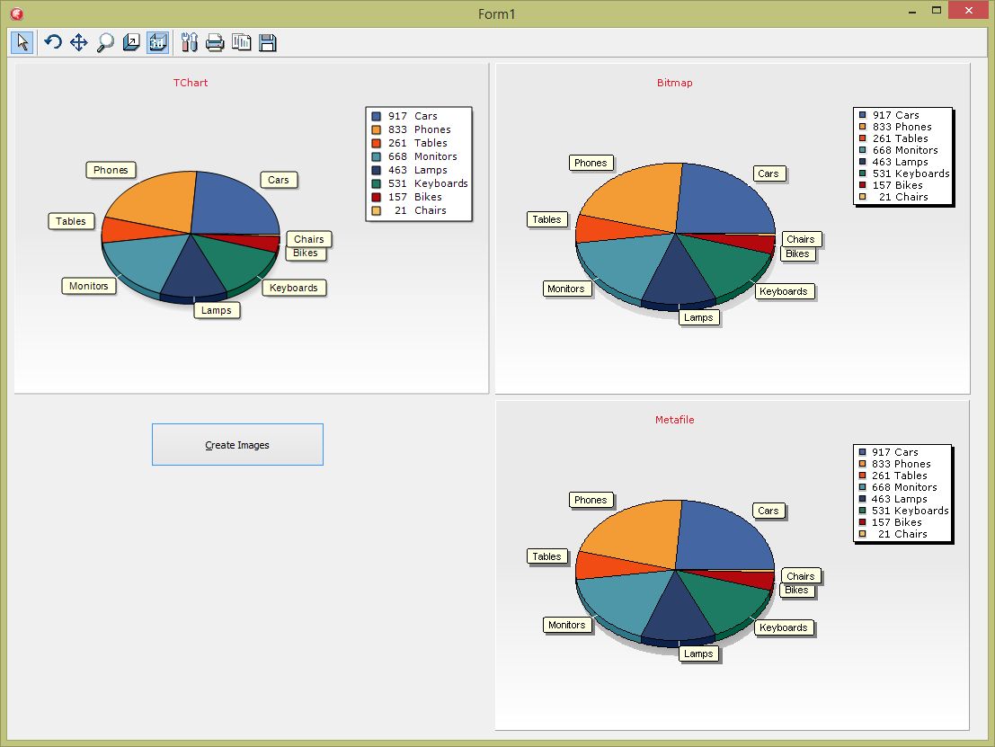

I just upgraded from Delphi 2010 and an older TeeChart version to Delphi XE6 and the current TeeChart from September 2014. I noticed that in the new version the bitmap output from TChart is blurred. This affects both the direct visual output to the screen, and the output of TChart.TeeCreateBitmap. In the chart editor and object inspector I could not find any new setting that would allow to switch between sharp and soft output, so I assume that it may be a bug.
I have added details from 6 screen shots, which for convenience I have assembed in one image. The top row shows the old version, and the bottom row the new version. Please zoom into the image so you can better see the problem.
On the left you see the direct output of the TChart on the screen. Note how all output (axis lines, axis labels and glyphs) is blurred now, compared to the sharp mouise pointer.
In the middle you can see the glyphs created from TChart.TeeCreateBitmap and then assigned to TSpeedButton.Glyph. They are blurred in the same way, while they were sharp in the past.
On the right side you can see the glyphs created from TChart.TeeCreateMetafile and then assigned to TImage.Picture.Metafile. They remain sharp also in the new version, which means that the general drawing in the TChart appears to be ok, and the problem only arises from the last step of rendering.
The glyphs now look different from the old version, e.g. the black outline of the red square has open cerners now, while thes were closed in the past. Have you changed the shapes of the glyphs with purpose?
Any suggestions? Thanks in advance for your help. Regards Uwe

Post by Narcís » Fri Nov 07, 2014 9:10 am
Hi UweK,
This is because GDI+ is now the default rendering canvas for aesthetic purposes. You can overcome that disabling the GDI+ canvas before exporting though:
var
  bmp: TBitmap;
  mtf: TMetafile;
  tmp: String;
  Chart1.Canvas:=TTeeCanvas3D.Create;
  tmp:=Chart1.Title.Text[0];
  Chart1.Title.Text[0]:='Bitmap';
  bmp:=Chart1.TeeCreateBitmap(clNone, Chart1.ChartBounds);
  Image1.Picture.Bitmap:=bmp;
  bmp.SaveToFile('blurred.bmp');
  Chart1.Title.Text[0]:='Metafile';
  mtf:=Chart1.TeeCreateMetafile(True, Chart1.ChartBounds);
  Image2.Picture.Metafile:=mtf;
  mtf.SaveToFile('non-blurred.emf');
  Chart1.Title.Text[0]:=tmp;
  Chart1.Canvas:=TGDIPlusCanvas.Create;
Which produces this:
Find also attached the complete project.
BlurredBitmap.zip
(53.98 KiB) Downloaded 607 times

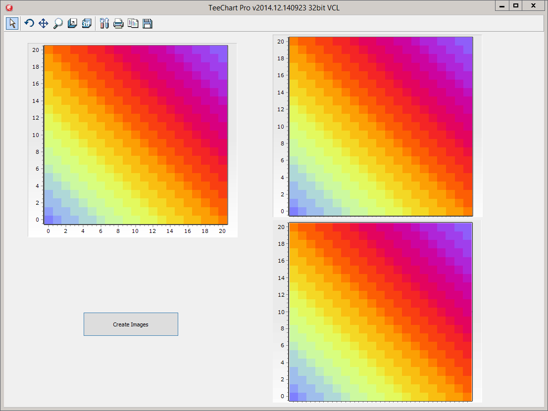

I'm getting an "Out of system resources" error as soon as I activate GDI (TTeeCanvas3D). But I can run it with a slight modification:
var I, J: Integer;
  Caption:=TeeMsg_Version;  // to verify what TeeChart version is being used
  //Chart1.Canvas:=TTeeCanvas3D.Create; // activate this line to see the bug
  with ScreenSeries do
    Clear;
    for I:= 0 to 20 do
      for J:= 0 to 20 do
        AddXYZ(I, I+J, J);
    UsePalette:= true;
  end; {with ScreenSeries}

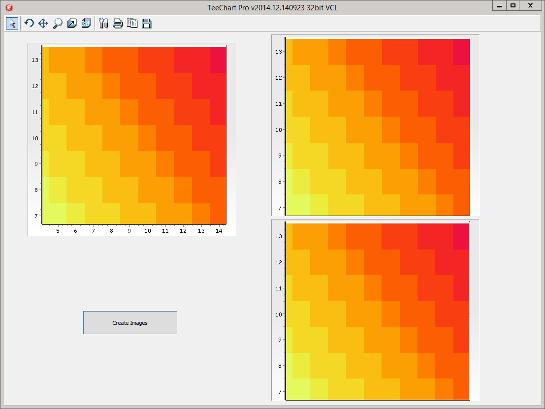

UweK wrote:First compile and run the program as it is, with the "Chart1.Canvas:=TTeeCanvas3D.Create" commented out so that the new TGDIPlusCanvas remains in effect. E.g. zoom into the TChart with the mouse, and everything is fine (except for the blurred bitmap).
With the modification above, this is what I get in GDIPlus (TTeeCanvas3D.Create line commented out):
UweK wrote:Now remove the comment characters around "Chart1.Canvas:=TTeeCanvas3D.Create" and recompile the program. The program starts with a message "Wrong parameter", on my PC it is in German. Then the behaviour of this test project is different from my program, but this may be because I have lots of other actions in between. Here you will never see the plot of the TColorGridSeries, while in my program at least I get it once, before the screen output of the TChart freezes. But the entire problem may completely disappear anyway when you find the reason for that error message.
I don't see any of these problems here.

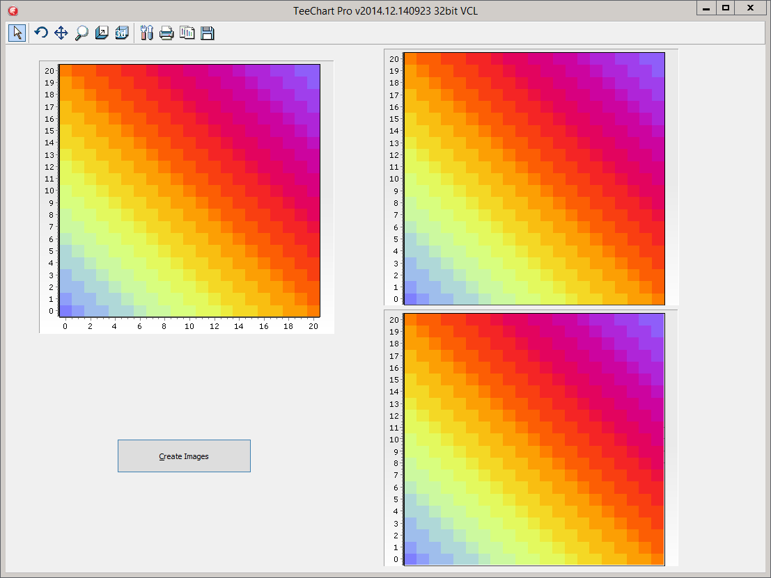

Using GDI (TTeeCanvas3D.Create line uncommented), this is what I get:
So I'm afraid I'm not sure to see anything blurred.

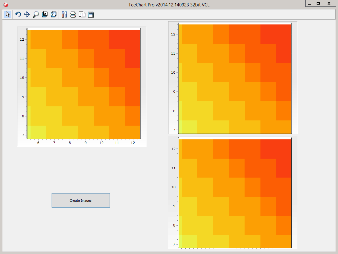

UweK wrote:If the line "Chart1.Canvas:=TTeeCanvas3D.Create" is moved into the TBitBtn.OnClick like in your project, the TChart is displayed in the beginning, and the bug occurs later when e,g, I try to zoom into the TChart with the mouse.
I only see a TGDIPlusCanvas commented out at the end of your Button1Click method. As it is, this is being applied to the main chart immediately but only to the bitmaps the next time the button will be called. This may be the explanation of the behaviour you are observing.
If I change it for what Narcís suggested, the main chart will be using GDIPlus and the exported charts should be in GDI:
