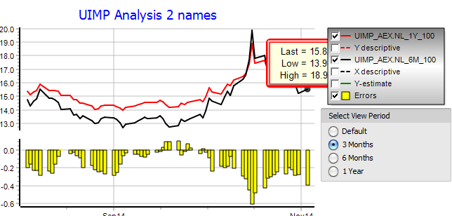

I have added a TPointserie to a chart with an event that shows the mark when hoovering over the point.
All works fine, only the mark (TMarksItem) is (partly) hidden by the legend (and other custom controls I added to the chart)
I use PointSerie.Marks.OnTop := true to have the item not being hidden by (other) series.
Is there a possibility to have it also "overlay" the legend?
(see attached screenshot)

I'm trying to reproduce the situation with the following code but the marks I get are always drawn over the legend:
uses Series, TeeTools;
var i, j: Integer;
    tmp: Double;
  Chart1.View3D:=false;
  for i:=0 to 4 do
    with Chart1.AddSeries(TLineSeries) as TLineSeries do
      tmp:=50+random*50;
      Add(tmp, 'this is a long labels for ' + sLineBreak +
          'Series ' + IntToStr(i) + ', Value: ' + FormatFloat('#0.##', tmp));
      for j:=1 to 24 do
        tmp:=YValues.Last+random*10-5;
      Active:=i mod 2=0;
  Chart1.Tools.Add(TMarksTipTool);
  Chart1.Legend.CheckBoxes:=true;
  Chart1.Axes.Bottom.LabelStyle:=talValue;
Could you please arrange a simpl eexample project we can run as-is to reproduce the problem here?
