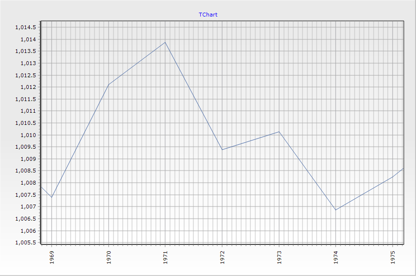

Hi Bruce,
If I understand you correctly, you have something like this:
uses Series, DateUtils;
var i: Integer;
    tmpDate: TDate;
  Chart1.Align:=alClient;
  Chart1.View3D:=false;
  Chart1.Legend.Visible:=false;
  with Chart1.AddSeries(TLineSeries) as TLineSeries do
    XValues.DateTime:=true;
    tmpDate:=StrToDate('1/1/1931');
    AddXY(tmpDate, 1000+random*50);
    for i:=1 to 2014-1931 do
      tmpDate:=IncYear(tmpDate);
      AddXY(tmpDate, YValue[i-1] + random*10-5);
  with Chart1.Axes.Bottom do
    Increment:=DateTimeStep[dtOneYear];
    DateTimeFormat:='yyyy';
    LabelsAngle:=90;
    MinorTickCount:=11;
    Grid.Color:=clMedGray;
    MinorGrid.Visible:=true;
    MinorGrid.Color:=clLtGray;
That, zooming a bit looks like this:

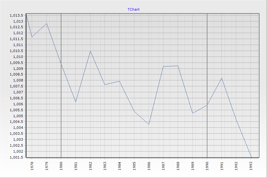

To highlight the decades, you could use TColorLineTools:
uses Series, DateUtils, TeeTools;
  procedure addColorLineIfDecade(year: Integer);
    if year mod 10 = 0 then
      if (Chart1.Tools.Count=0) or
         ((Chart1.Tools[Chart1.Tools.Count-1] as TColorLineTool).Value<>year) then
         with Chart1.Tools.Add(TColorLineTool) as TColorLineTool do
           Axis:=Chart1.Axes.Bottom;
           Value:=StrToDate('1/1/'+IntToStr(year));
           AllowDrag:=false;
var i: Integer;
    tmpDate: TDate;
    addColorLineIfDecade(YearOf(tmpDate));
    LabelsAngle:=90;
    MinorTickCount:=11;
