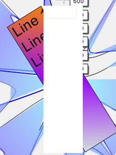

I believe the TCustomLegendTool is broken. Just create a new chart, add some series, and try to add a TCustomLegendTool. My observation is that it works flawlessly, except for the fact it is covered by a entirely opaque, inaccessible white surface. Have a look:
Custom Legend broken.png (24.68 KiB) Viewed 6363 times
Is there any way around it or do I have to wait for the next release?

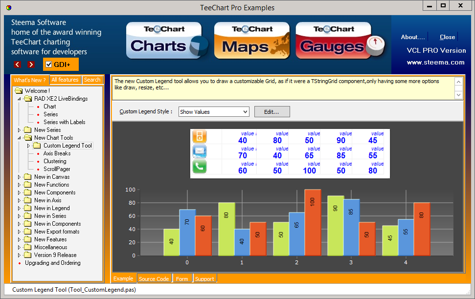

Take a look at the example at "What's New ?\Welcome !\New Chart Tools\Custom Legend Tool" in the features demo. In the example shipped with v2014.12 it shows a bit strange even after resizing it but the example is still valid to show how it should be used, using its Grid.OnDrawCell event to manually draw the elements in it.
