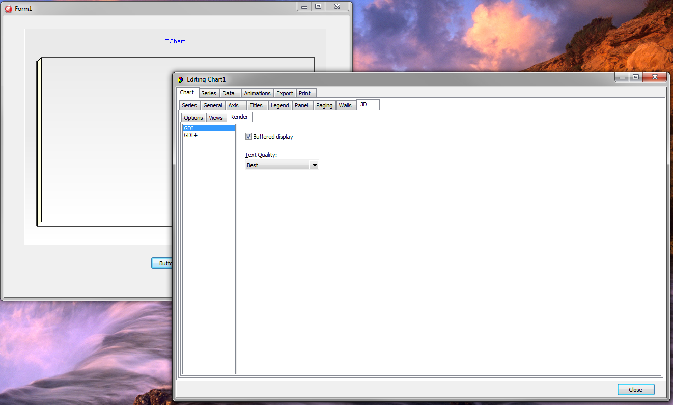

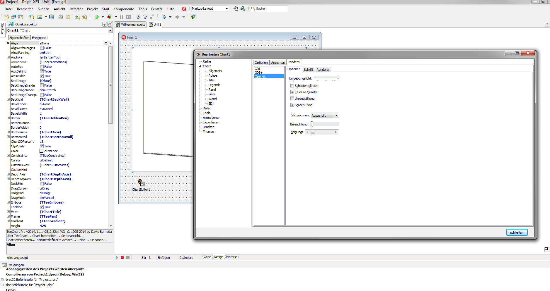

May be my question is a stupid one. But I can't see OpenGL Option at runtime. It meens when I am in design mode I definitley have the OpenGL Option (see Screen01.png) but when I start the application and call the editor I only can choose between GDI and GDI+ (see Screen02.png). What's wrong?

Re: OpenGL not available
Post by Yeray » Tue Sep 23, 2014 1:30 pm
Hi Markus,
You are probably missing to add TeeOpenGL unit to the uses clause:
uses TeeOpenGL;
