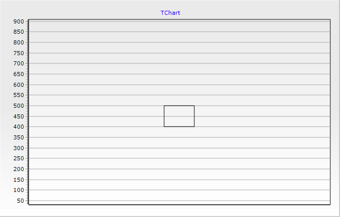

Here the complete code of an example I just made to check it:
uses Series, TeCanvas;
  Chart1.View3D:=false;
  Chart1.AddSeries(TFastLineSeries);
  Chart1.Axes.Left.SetMinMax(33,909);
  Chart1.Axes.Bottom.SetMinMax(0,100);
  Chart1.Axes.Bottom.Labels:=false;
var tmpLeft, tmpRight, tmpTop, tmpBottom: Integer;
  tmpLeft:=Chart1.Axes.Bottom.CalcPosValue(45);
  tmpRight:=Chart1.Axes.Bottom.CalcPosValue(55);
  tmpTop:=Chart1.Axes.Left.CalcPosValue(400);
  tmpBottom:=Chart1.Axes.Left.CalcPosValue(500);
  Chart1.Canvas.Brush.Style:=bsClear;
  Chart1.Canvas.Rectangle(tmpLeft, tmpTop, tmpRight, tmpBottom);
I'm drawing a rectangle with OnAfterDraw event to check the bottom axis has the correct minimum and maximum values. Because once you hide the labels, you loose that reference.

thank you so much for this genius and complete solution!
