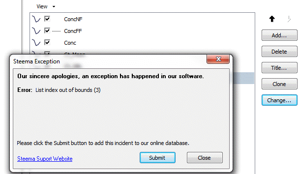

Without warning I can no longer no longer change the type for a chart series. I right click on a chart and select "Edit Chart". I then select a series and click on "Change". At this point I get a "Steema Exception" form stating
"Our sincere apologies, an exception has happened ........ Err: List index out of bounds (3)".

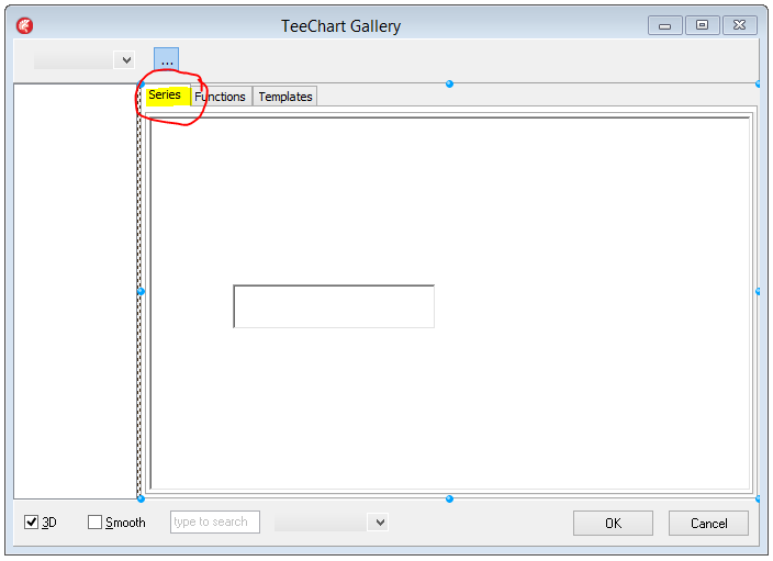

Anyway found a fix - so I dont need to install new stuff... (if you have the source)
In the "VCLTee.TeeGally" unit make sure the selected tabsheet for TabTypes is "Series" - shown in attachment, then it Works...
Christian, DHI

I made sure that the Series tab was selected (I clicked on Add series to do this), but I still get the same error. See attached gifs.
This seems like a major major issue that should be fixed immediately and a new build offered to paying clients. I have now lost all ability to change the type for a series.
Paul
TeeChart change series error.gif (35.39 KiB) Viewed 10343 times
