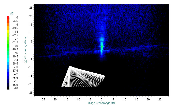

Sandra,
Thanks for your response. I am a source code client using TeeChart Pro v2013 32 bit. My application is now exactly like the code you have in this post. When I move the mouse, the old lines still are not removed. I have attached a screen shot showing my issue. This image was drawn on a TColorGridSeries. As you can see in the image, the white lines at the bottom were created after a mouse down and mouse move events.

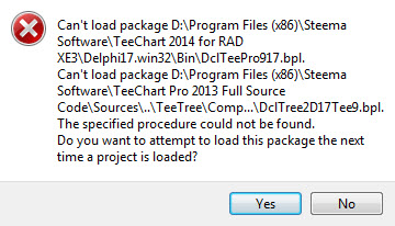

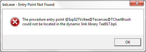

Thanks again for you response. I downloaded the latest version and installed it. When I open the project I get the following errors. I first get this one:
First Load Error.jpg (29 KiB) Viewed 32930 times
I then get this one:
Second Load Error.jpg (49.07 KiB) Viewed 32931 times
Any thoughts? I think I have all the paths correct, but I must not. Can you advise me on how to fix this? Thanks in advance.

Post by dpatch » Wed Aug 06, 2014 12:48 pm
OK, I uninstalled 2014 and reinstall it and this fixed the install problem. And, more importantly, the new version also fixed the line drawing problem.

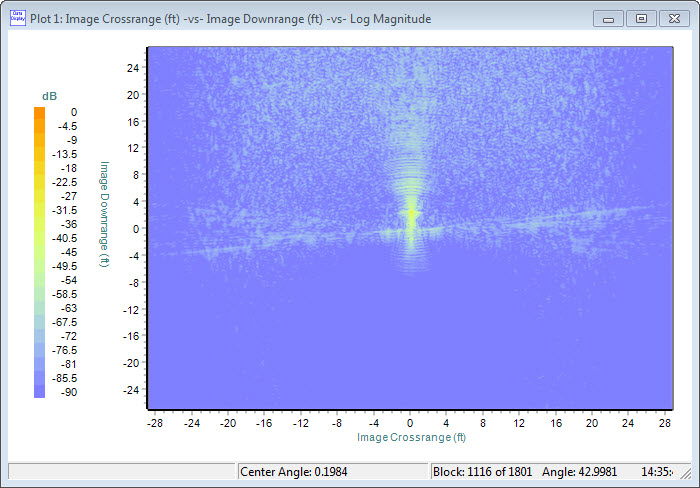

Post by dpatch » Wed Aug 06, 2014 2:53 pm
OK, I have worked through all the issues except the color palette. Before installing the latest update, my image was drawn as shown above. Now, without code change, the image color is drawn as shown here:
Image Color.jpg (107.75 KiB) Viewed 32925 times
What do you think changed? I call ClearPalette and AddPalette the same as I always have. It seems that where the palette is getting initialized internally has changed, meaning it is being initialized after I set it. If I set it again after displaying the incorrect image, it modifies the palette and displays the image as I expect. Any insight would be helpful.
Thanks!
Re: Line drawing
Post by Yeray » Thu Aug 07, 2014 9:55 am
dpatch wrote:OK, I have worked through all the issues except the color palette. Before installing the latest update, my image was drawn as shown above. Now, without code change, the image color is drawn as shown here:
Can you please try to arrange a simple example project we can run as-is to reproduce the problem here?

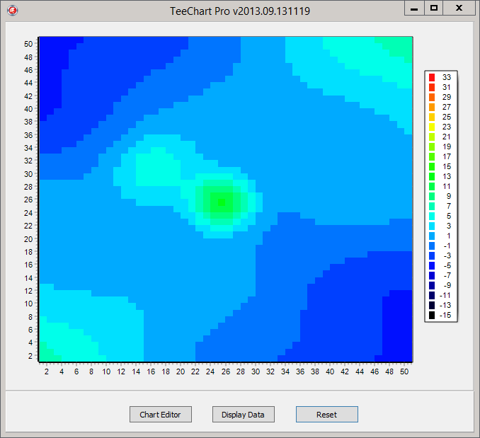

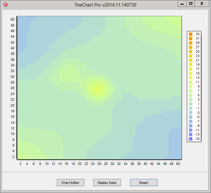

Yeray,
OK, I attached a small project showing my inability to change the color palette. This code used to work, and every once in a while I make a change in the chart editor that causes the color on either the plot or the legend to change and be correct. But, it is not repeatable. Once it changed the plot when I switched between GDI and GDI+. another time it changed the legend when I made it not visible, then visible again.
I took this example from another example I sent you a number of years ago. In that example, we were debugging something else, but the colors worked and the "PolyLine method also worked. I have included a snapshot of the screen for you to see what the colors should be.
When you look at the app attached, do you see anything wrong?
Color Grid.zip
(239.27 KiB) Downloaded 1575 times
Re: Line drawing
Post by Yeray » Mon Aug 11, 2014 10:36 am
I've tried your testing application with all the versions from v2012.07 to the actual v2014.11 and found the palette seems to change from v2014.10. And switching to GDI doesn't change it.
Here is how it looks in v2013.09:
And this is how it looks in v2014.10 and v2014.11:
http://bugs.teechart.net/show_bug.cgi?id=880
