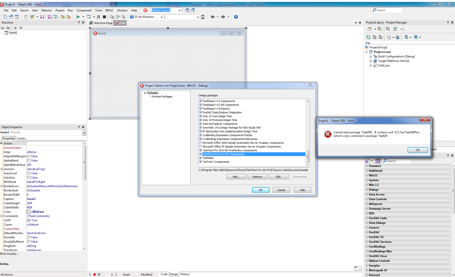

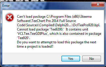

There seems to be a problem with installing the latest version TeeChart Pro 2014 on Delphi XE6 latest version.
After recompiling a fresh startup of Delphi; see picture ‘Teechart1.png’. Once in de IDE try to activate the VCL package see picture ‘Teechart2.png’.
I had hoped that recompiling would solve this issue. That is clearly not the case. The beta version runs. Just to be sure there were no virus checkers active.
I hope that you can help solving this issue.
The current installation simply doesn't work on Delphi XE6. 'The beta version runs' (only XE5).

Hi mark,
The machine I'm running is Windows 7, with Delphi XE6 Enterprise with update 1. Removed all Teechart components and all path reverences from Delphi XE6. Deactivated the virus checker (Avast gave some problems in the past). Then a fresh install of teechart 2014 (140514) latest full source version (TeeChart2014SourceCode.exe). After this install, Recompile.exe (run as an administrator) selected only XE6 as IDE and selected all pachages except 'Decision Cube' . Pressed begin and waited for the result;

Re: Installation TeeChart v2014
Hello Ernest,
Many thanks for the information.
The error message "Cannot load package Tee9XX. It contains unit *, which is also contained in package Tee9XX0" indicates that the TeeChart package that was shipped with the IDE (Tee9XX0) is still trying to be loaded, and this creates a conflict with the version you've just installed.
Note XX above refers to the IDE number. For XE6 it's 20, XE5 was 19, XE4 was 18,...
I am seeing in the attached image, the FastReports packages are active, I think this can be the problem, so that are still using the old TeeChart versions. You could try disabling them and enabling new TeeChart packages.
Hoping it will help.
Thanks in advance,
Thanks in advance,
Hi Sandra,
You're completely right ! FastReport VCL is causing this problem.
Hmm.. one problem solved, one new problem created
Thanks !
Best regards,
Ernest
Thanks !
Best regards,
Ernest
