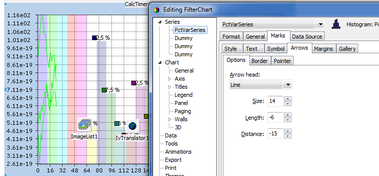

I tried to have a line from my marks in a histogram series but either 'Line' nor 'Solid' nor any of the parameters below seem to do anything...
The intention was to move the text inside the bar and to prevent them from beeing outside of the chart itself (as I clip it). But as it seems the Marks position cann't be changed at all, it stays centered and showing the 'Symbol' does overwrite the label.

Hello Whookie,
You can add the marks on the bar, if you set the MarksOnBar property to true as do in line code below.
 Series1.MarksOnBar := true;
Also, you can find a complete example in the Demo project, concretely in the Whats's New->New in Series-> Marks on Bar. You find the Demo project in a similar path as next:
