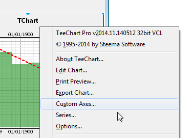

How do I check for the exact build number?
To check the exact build number, the easiest way is next:
1.- Open your IDE, add Chart in the form and then do click on chart with right button and choose About TeeChart.

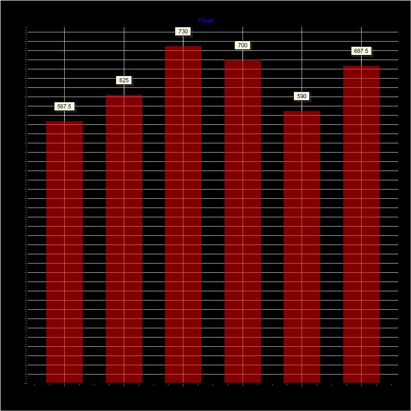

The result did have transparent bars yes, but...
Is the version of TeeChart that I'm using the latest version or not (2014.11.140512)?
I installed XE6 the week before I added TeeChart 2014 on a Windows 7 PC.
