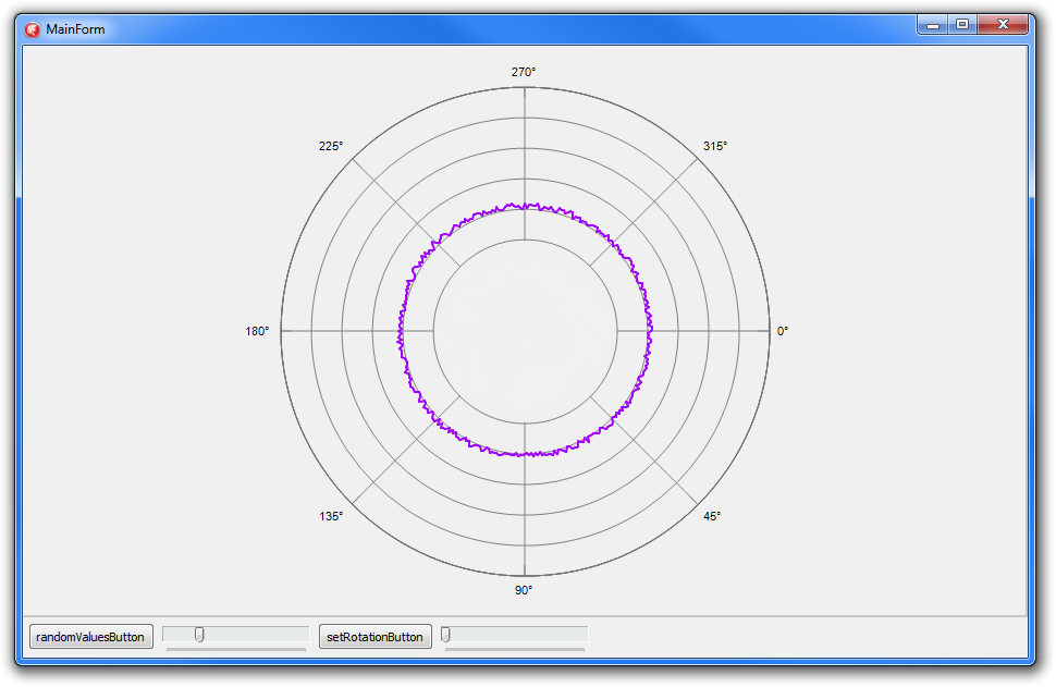

First, we had a pie series. Later came the donut series which is basically a pie series with a hole in the middle. Is something like this also possible for a TPolarSeries?
A polar series looks like this:

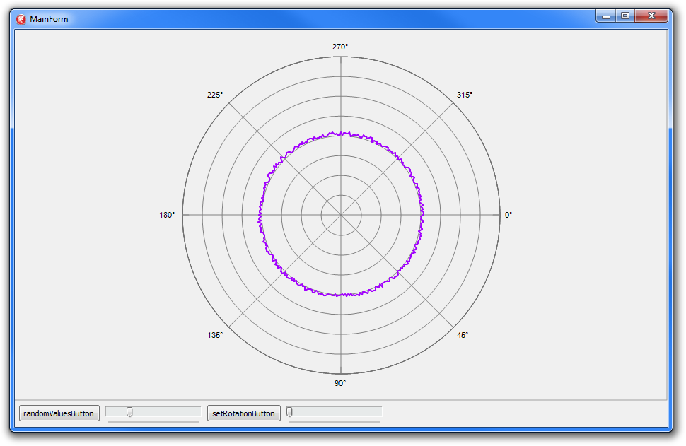

I am now looking for something like this:

How could this be achived? My main goal is to have an "axe" every 45° (like in the pictures) but not having them collide in the centre of the chart. I don't really care about the rings, I'm going to have them drawn manually either way :wink:

This is not possible for now, I'm afraid. So I have added your request to bugzilla (ID849) to be considered for inclusion in future releases.

By the way, I stumbled upon the method TCustomPolarSeries.DrawZone(Const Min, Max: Double; Z: Integer).
Wouldn't that be able to achieve what I'm looking for?
Re: Could I have a hole in my polar series, please?
Post by Narcís » Wed Jul 16, 2014 8:18 am
Sort of. There's an example of DrawZone at All Features\Welcome!\Chart Styles\Extended\Polar\Zones in the new features demo, included with the binary installers and available at the TeeChart program group. The problem is this seems to be broken now. I have added it to the bug list (ID850). IIRC, this draws the zones behind the series. If this fits your need, then you'd already have a solution when this is fixed or using an older TeeChart version where this worked. I don't know when this was broken though.

Good to know, I thought it was me not being able to use DrawZone(..) correctly.
DrawRing(..) however works like a charm.
