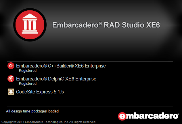

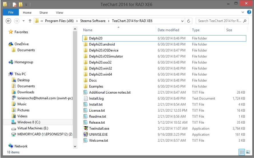

I just installed TeeCharts Pro for XE6. When I opened the component list, it show TeeCharts Pro for XE6 Starter but I have Enterprise. I originally had the Starter edition but upgraded to Enterprise.
When I looked at the installed TeeChart files, it appears that it only installed the ones for Delphi Starter Edition (See attachments).

- Only Delphi TeeChart Files
- Installed.jpg (140.59 KiB) Viewed 17496 times
- Enterprise
- Ent.png (68.96 KiB) Viewed 17435 times

On the other hand, having TChart component in the "Standard" tab in the palette doesn't mean you have TeeChart * for Starter Edition, nor TeeChart Standard. Note TeeChart Standard that is shipped with the IDE is placed in this "Standard" tab and installing any other version mail fail when trying to move this from a section to another on the palette, even if it points to a different version of the component. To be sure about what version you have installed, open the list of Packages in the IDE ("Component /Install Packages...") and check what bpls are selected.
The image looks as a normal TeeChart Pro installation.
As indicated above, open the list of Packages in the IDE ("Component /Install Packages...") and check what bpls are selected. You should have these selected:
- C:\Program Files (x86)\Steema Software\TeeChart 2014 for RAD XE6\Delphi20.win32\Bin\DclFMXTeePro920.bpl
- C:\Program Files (x86)\Steema Software\TeeChart 2014 for RAD XE6\Delphi20.win32\Bin\DclTeePro920.bpl
- C:\Program Files (x86)\Steema Software\TeeChart 2014 for RAD XE6\Delphi20.win32\Bin\DclTeeMaker120.bpl
- C:\Program Files (x86)\Steema Software\TeeChart 2014 for RAD XE6\Delphi20.win32\Bin\DclTree2D20Tee9.bpl
