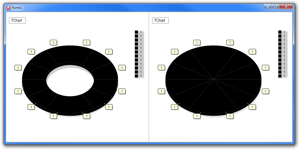

The pie and donut series both provide a "No border" template. However, when painting them with GDI+ and anti-alias (which is the default), they still have visible seams where they'd draw their border. Turning anti-alias off brings back memories from 1995 but removes the gaps.
Please see the following image:
Black is beautiful

and the charts look like this.
Is this intended? Should I file a bug report?

I've been able to reproduce the problem so I've added it to the public tracker:
http://bugs.teechart.net/show_bug.cgi?id=816
