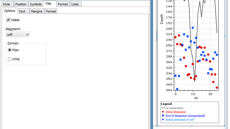

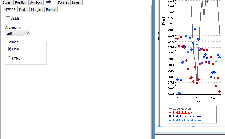

Attached you can see that switching the visibility of the legend title affects the border rectangle (latest TChar Pro 2014, XE6, Windows 8.1)
Legend title off.gif (14.64 KiB) Viewed 14121 times
Legend title on.gif (15.85 KiB) Viewed 14097 times

Post by Yeray » Fri Jun 20, 2014 11:25 am
Take a look at the project attached. I can't reproduce the problem with it, can you?
testLegendTitle.zip
(1.88 KiB) Downloaded 1429 times
Could you please modify it so we can reproduce the problem here?

Post by johnnix » Fri Jun 20, 2014 12:55 pm
Take a look now (I pasted my original plot). Please also notice that the left axis title does not appear to be drawn around the middle of the axis rather than starts from the middle.
Project1.zip
(4.53 KiB) Downloaded 1316 times

Post by Yeray » Fri Jun 20, 2014 3:31 pm
johnnix wrote:Take a look now (I pasted my original plot).
I've reproduced it with v2014.11 but not with the actual sources, so I'd expect this to be fixed with the next maintenance release.
At Chart.pas you'll find a nested function with the signature:
Function CalcColumnsWidth(NumLegendValues:Integer):Integer;
Just add this at the beginning of this function:
ParentChart.Canvas.AssignFont(Font);
