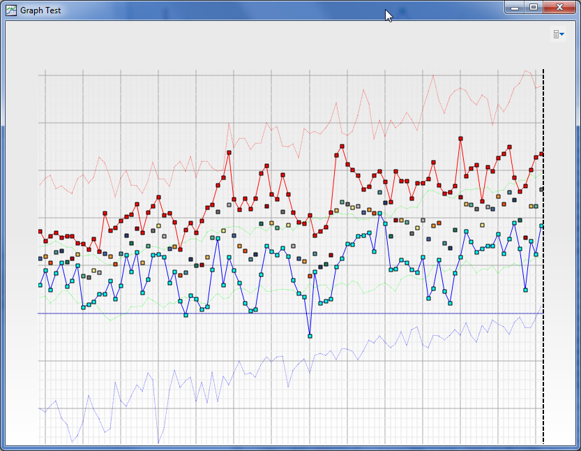

I am having problems improving the sharpness and clarity of graphs that were reasonably good when using TeeChart 8.

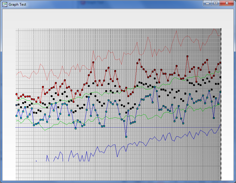

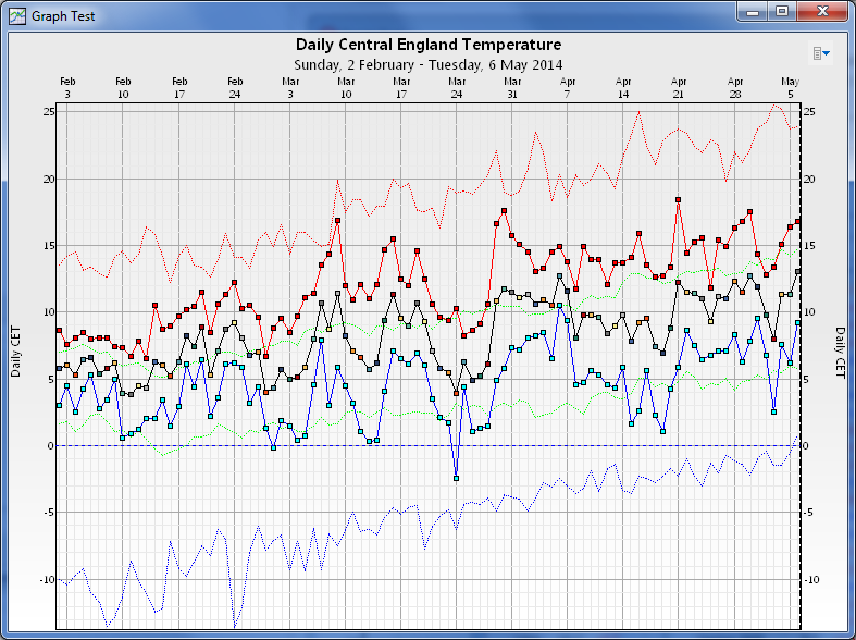

I thought it would be as easy as dropping a GDIPlus or TeeOpenGL (non-visual) component on the form and then hooking up to the chart.
When I try it using either method any text, labels and titles that I had in my chart disappear in the IDE as I make it active, and are also missing when I build and run the application. Is this a problem with my development system - I'm running on Windows 7 - or am I missing something?
Bare bones app
old code.png (61.6 KiB) Viewed 8698 times
Using GDI Plus
GDI Plus.png (107.02 KiB) Viewed 8683 times
Using Open GL
Open GL.png (99.58 KiB) Viewed 8686 times

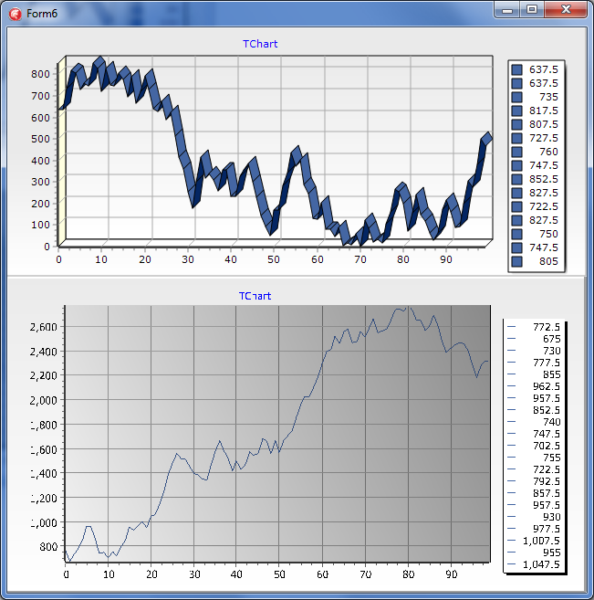

Here's a test project:
Screen shot
I've attached the zip source but all I've done is dropped two charts on a form connected the top one to GDI+ and the bottom chart to Open GL and added some sample data,
There seems to be a bit of a lag when the test application first opens and I'm only adding 100 sample points to each chart.
The GDI+ is the top one and now looks better. The grid lines are blurred but sharpen when anti-aliasing is set false.
The Open GL is the lower one and although the graphics look OK, the text looks very poor even though anti-aliasing is set true. Setting anti-aliasing to false makes no difference. The other thing I've noticed is that the component occasionally goes black in the IDE.

Re: Problems moving to XE6 with 2014
Post by Yeray » Tue Jun 17, 2014 11:09 am
Hi Bruce,
Metman wrote:There seems to be a bit of a lag when the test application first opens and I'm only adding 100 sample points to each chart.
This has always been like that, isn't it? OpenGL needs some time to initialize.
Metman wrote:The GDI+ is the top one and now looks better. The grid lines are blurred but sharpen when anti-aliasing is set false.
You may be interested on looking at this discussion.
Metman wrote:The Open GL is the lower one and although the graphics look OK, the text looks very poor even though anti-aliasing is set true. Setting anti-aliasing to false makes no difference.
This is a known issue with the texts:
http://bugs.teechart.net/show_bug.cgi?id=802
Feel free to add your mail to the CC list to be automatically notified when an update arrives.
Metman wrote:The other thing I've noticed is that the component occasionally goes black in the IDE.
I see it when I click on the chart in your project, but not if I drop a new one, I drop a Line series, I change the Render to OpenGL and I click on the chart.
Metman wrote:Frustratingly to me, all this test proves is that I can't upgrade from 2008 to v2014.11 without having to rebuild every Chart component that I use from the ground up (and I use hundreds) because they won't seamlessly upgrade.
I'm sorry to hear that. We'll try to reproduce and check what's going on in every property or feature you can report us to be changing its behaviour between versions.
