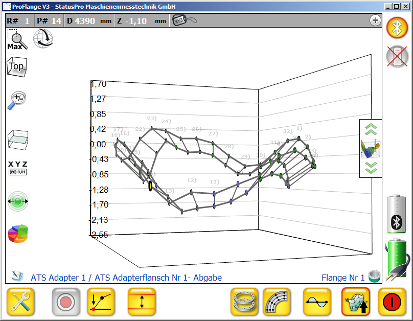

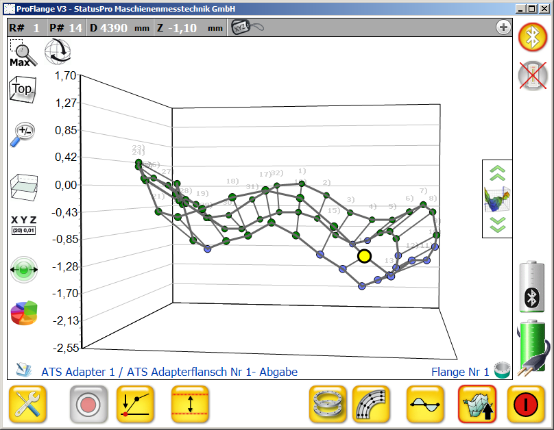

I'd like to draw a Point3D series like it is drawn in 2D.
Currently if I turn the chart (Rotate Tool) the points are drawn as ellipses with perspective deformation applied to them.
I'd like to see them as simple circle from all views.
Best would be to have "bubbles" or "balls" like it is 3D - but simple circles are good as well.

- Points as ellipses
- Flange2.png (153.82 KiB) Viewed 10357 times
- View of Points like circles
- Flange1.png (157.91 KiB) Viewed 10360 times
