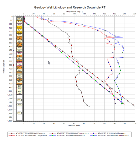

I wish to plot a range of different graphs using a common left axis but with separate chart areas. To illustrate, in the attached example, I would like the bar chart in one area and the line chart in a separate but contiguous area, with separate properties (e.g. vertical zoom in the bar chart, general zoom in the line chart.
To complicate this, I cannot assume any axis ranges for the line chart - normally the graphs will auto-range. Furthermore, I want to be able to hide the bar chart or the line chart area if no data of that type is present.
Any general suggestions would be greatly appreciated.

Hi Errol,
- Custom axes would probably be the easiest solution. However, the zoom and scroll features will be dependant.
See the Opaque Zones example shipped with the features demo (All Features\Welcome !\Axes\Opaque Zones).
- The SubChart tool allows you to draw a second chart in the same area where the first chart is. This allows you to have zoom and scroll independant.
See SubChart tool examples shipped with the features demo (All Features\Welcome !\Tools\SubCharts).
- Create two charts and set the margins manually to make one to be draw next to the other.
If you work with SubCharts, you can always hide or make visible the charts in the subchart tool. After it, you will also have to recalculate the position and size of the visible chart.
If you are working with two different charts, you should proceed as with the chart into the subchart tool. You can hide a chart and recalculate the position and size of the visible one.
I can think on three options:Errol wrote:I wish to plot a range of different graphs using a common left axis but with separate chart areas. To illustrate, in the attached example, I would like the bar chart in one area and the line chart in a separate but contiguous area, with separate properties (e.g. vertical zoom in the bar chart, general zoom in the line chart.
I'm not sure to understand what do you exactly mean here. If you set the axes to be automatic, the chart will calculate the axis range to fit the values visible in it. If you set the axis to be manual, you'll have to calculate and set the minimum and maximim yourself.Errol wrote:To complicate this, I cannot assume any axis ranges for the line chart - normally the graphs will auto-range.
If you work with custom axes, hiding all the series linked to an axis makes the axis not to be drawn. So, in this situation, you just need to recalculate the visible axes positions.Errol wrote:Furthermore, I want to be able to hide the bar chart or the line chart area if no data of that type is present.
