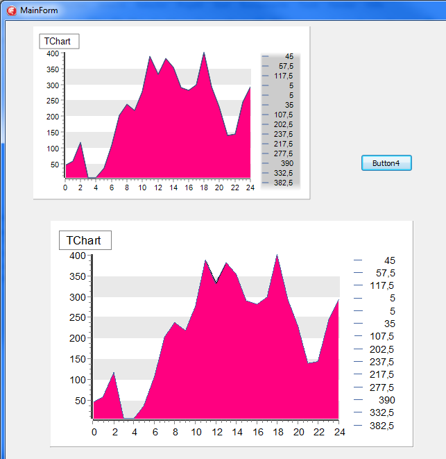

Let's consider the attached example screenshot:
chart deep copy.png (49.93 KiB) Viewed 10707 times
On the left, the original chart has a TGridBandTool as well as a region tool. The right chart obviously doesn't have those. Here is my code:

Anything unusual with that? I believe those two examples don't work because they still point to the axes of the original chart. That would also explain why stuff like a "cursor" can be copied over to another chart without problems.
Any suggestions or workarounds? Basically, I just want to create an exact copy of a chart.

The problem is indeed the same, I however don't quite understand your workaround. I find it much easier to clone all tools and check them if they're an instance of TTeeCustomToolSeries or TTeeCustomToolAxis and adjust them to the new chart, if necessary.
This way, I now have a nice copy I'm happy with:
chart deep copy - success.png (47.84 KiB) Viewed 10661 times
In case you're interested, this is how I cloned the tools. If you got the time, would you mind having a quick look at it? I'm not sure if I overlooked something (except handling the TTeeCustomAnimation subclass of TTeeCustomTool).
