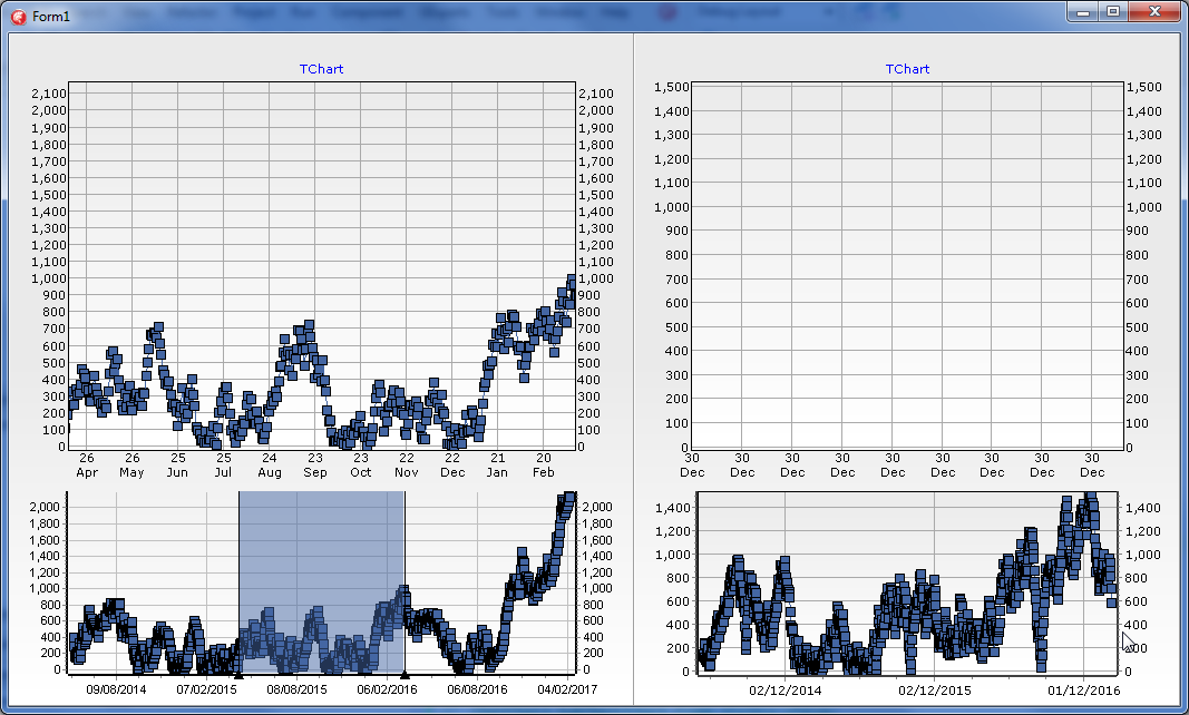

I have zipped the test project and attached it. The chart on the left that I create the ScrollPagerTool dynamically works fine. The on on the right fails to show a graph in the sub-chart.

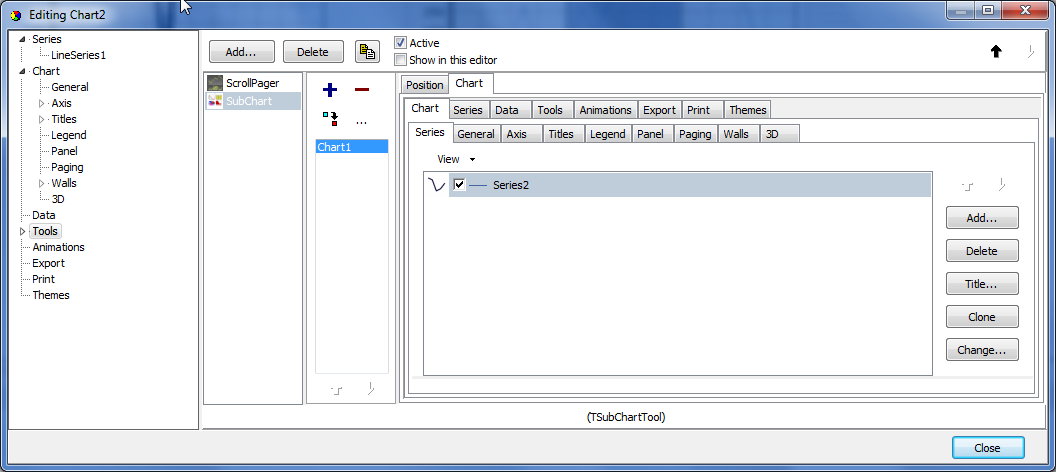

Should Chart2 show a reference to Chart1 as it does here?

I see your main chart is called Chart2. When you create a TScrollPagerTool, a TSubChartTool with a TChart is internally created. And the TChart created internally takes the name Chart1, yes, that's normal.
However, since you can access the chart in the TSubChartTool through the TScrollPagerTool, I think we could hide the TSubChartTool from the list of tools.

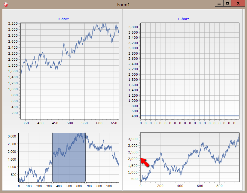

In your Chart2, where the TScrollPagerTool has been placed at design time, the series linked to it has 25 values, and note this tool sets its default ColorBand Start and End values according to the values in the series linked at the moment of the linkage is being done. Then, you are setting the series to have 1000 values, but the tool has already been initialized, so it isn't reinitialized again after changing the series values.
When I run your test application, I see the image below. The ColorBand in the right chart (Chart2) is present. It's just that it goes from 8 to 16 in an axis scale from 0 to 1000. So the whole ColorBand is in the left of the chart, where you see an arrow:

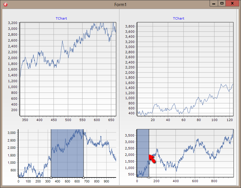

You can drag the ColorBand and see how the chart above changes.
