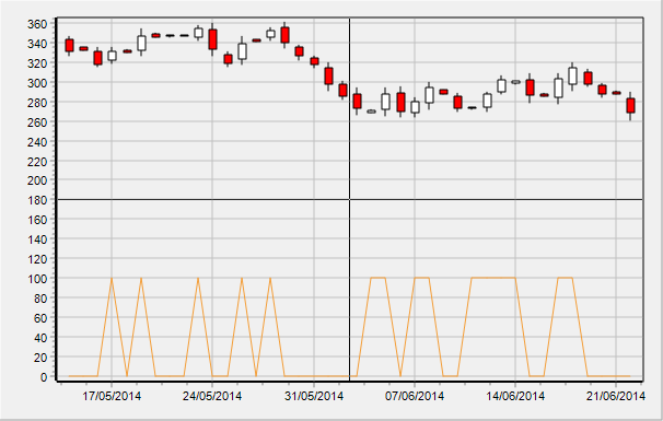

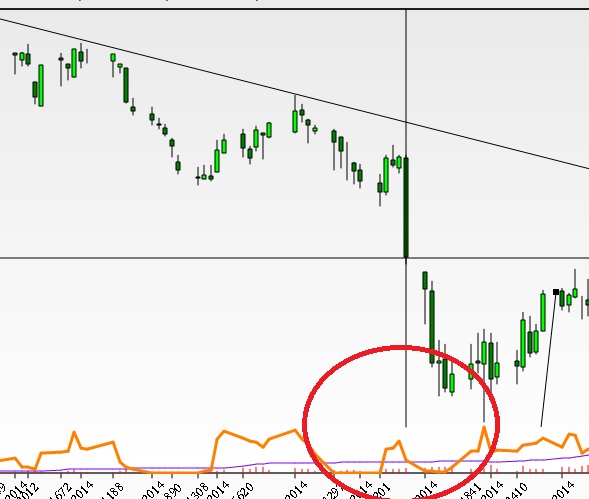

is it possible to add a crosshair not to a series, but to a chart?
Please see the screenshot: It has a crosshair tool added to the candle series.
Its vertical line does not reach the function series, which would be interesting to compare.
See red circle around the "not reaching".
So my question: is it possible to have a crosshair to 2 series or to a chart or to a series including its function?

You will (probalby) see, that the crosshair will look "short" / not reach the RSI series - as on my screenshot.
This is normal for the tool / functions. At least for me.
For this reason I asked, what I can do as an alternavtive for a vertical line above ALL series.

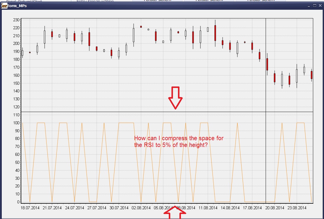

What I cannot do is the scaling. I make you a screenshot to show you WHICH scaling.
Sincerely,
Cheryll

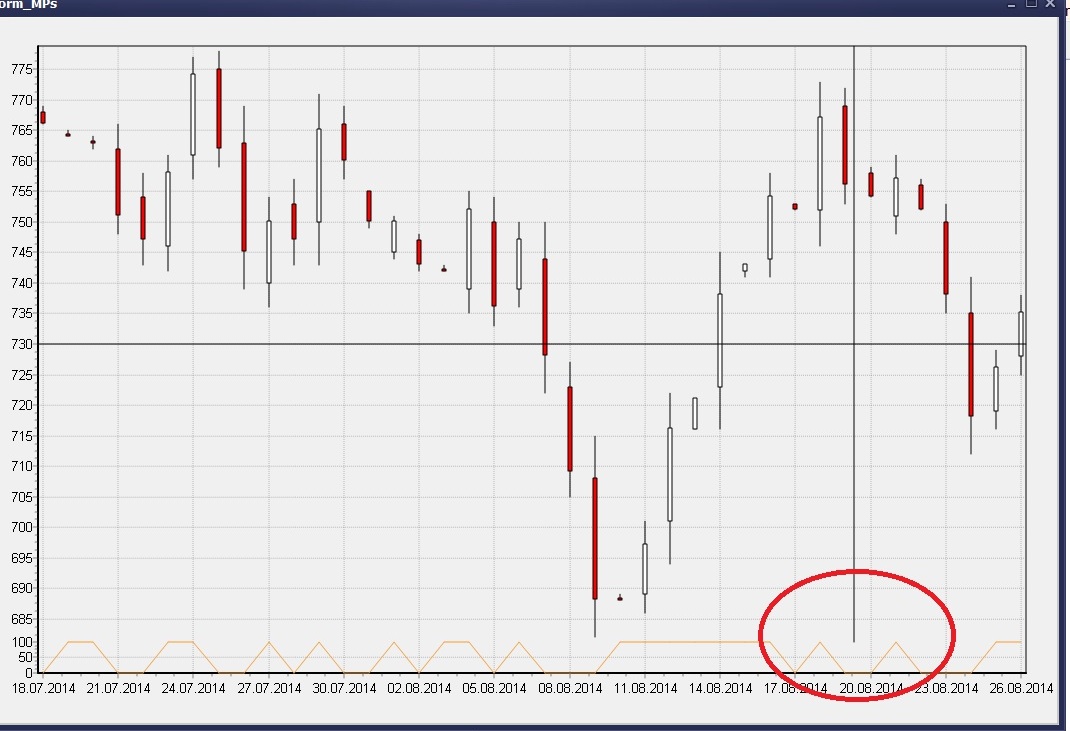

And now we did it. We have a code now, where the original problem occurs (pls. read original posting).
I send you a screenshot. The split of the axis makes it.
What can I do, that the cursor goes down to the bottom?
I do not have only an RSI. I have several extra axis of which it is hard to see exactly which candle they belong to.
If the cursor tool does not do it, I am grateful for any work-around.

Ok, back to your original question:
You could even try implementing horizontal cursor synchronization similar to what's shown in the All Features\Welcome!\Tools\Cursor\Synchronizing Two in the new features demo, available at TeeChart's program group.
Would that fit your needs?
Yes. However, your custom axis scenario doesn't allow this.is it possible to have a crosshair to 2 series
Yes, not assigning it to a specific series. Again, this doesn't apply for such custom axes charts.or to a chart
Yes, you could add another cursor tool associated to the function series, for example:or to a series including its function?
Chart_MP.Tools.Add(TCursorTool);
(Chart_MP.Tools.Items[1] as TCursorTool).Series:=line1;
