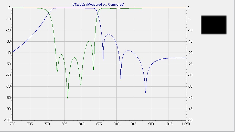

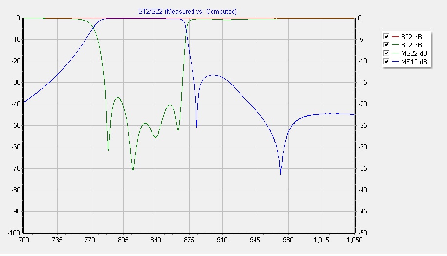

I've just upgraded one of my projects from BCB XE to BCB EX5. It compiled ok, but when I run the program, at first the legend displays ok, but when I refresh ChartSeries, the legend turned in to a black box. I've attached two images. One is before refreshing hte series and one is after.

We've identified a similar problem here. Are you using GDI?
If you can't switch to GDI+, can you please arrange a simple example project we can run as-is to reproduce the problem here, so we can try to suggest you another workaround?

Yes, I'm using GDI+. I switched to GDI and still have the same issue.

Bill wrote:Yes, I'm using GDI+. I switched to GDI and still have the same issue.
Can you arrange a simple example project we can run as-is to reproduce the problem here?
