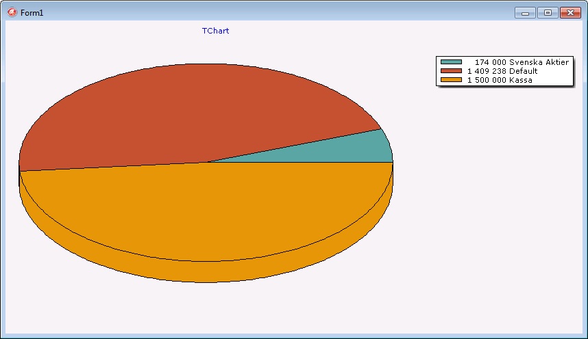

Everything is ok:
All is fine...
Pie ok.jpg (53.78 KiB) Viewed 5201 times

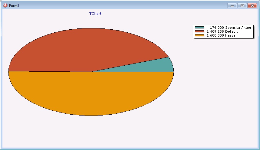

Changing the last slice value:
3d "effect is gone"
Pie not ok.jpg (48.14 KiB) Viewed 5211 times

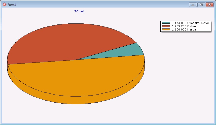

Changing rotation fixes 3d effect:
Changing rotation fixes it
Pie ok again.jpg (55.36 KiB) Viewed 5199 times

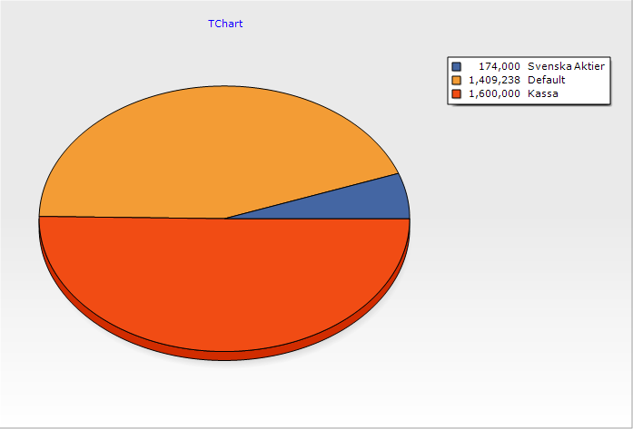

However, the same code above seems to work fine for me here with the actual sources and also with v2014.11 SourceCode Beta, so I'd expect this to be fixed with the next maintenance release. This is what I get with them:
