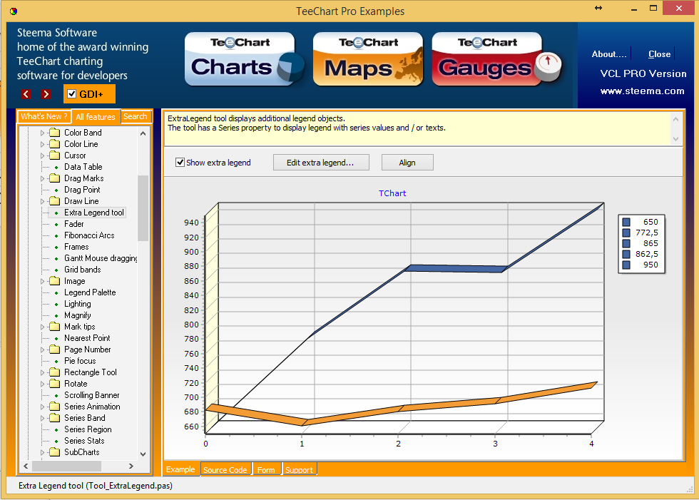

See attached screenshots.

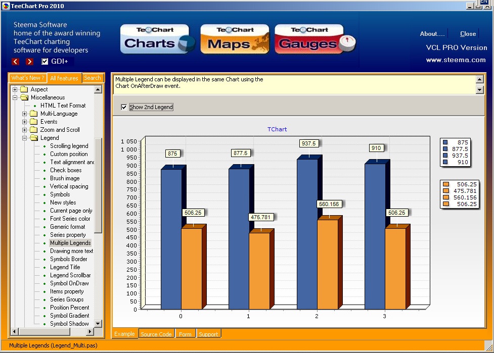

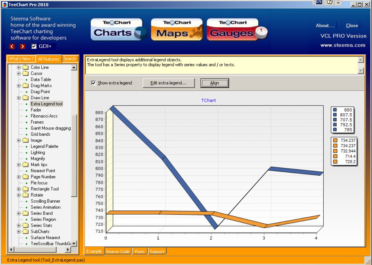

current behavior
Expected behavior

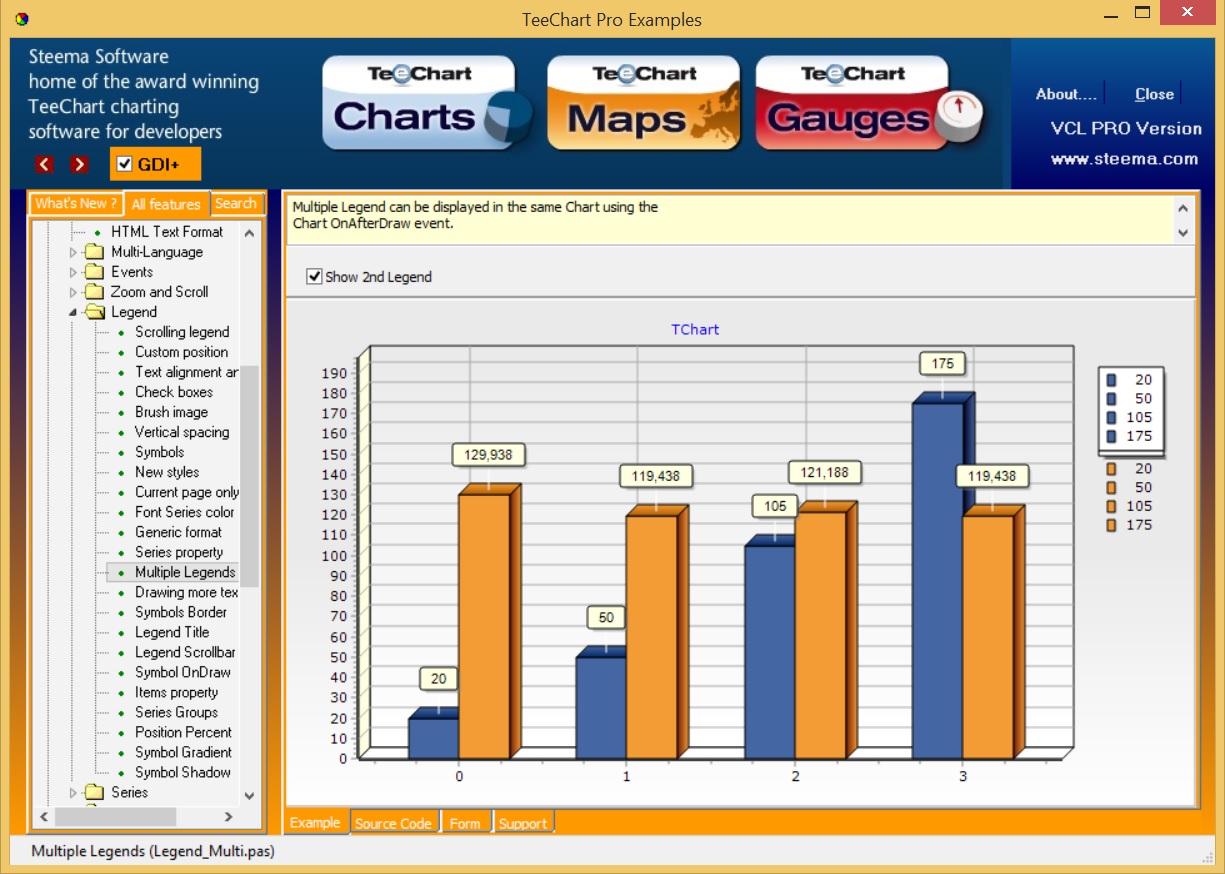

current behavior
expected behavior
On a side (and probably unrelated note), there seems to be a slight glitch in the legend-canvas drawing stuff
in the latest demo of Multiple Legend in the demo of Tee9New_win32.exe
(GDI+ selection/deselection does not impact the resulting output)
Bottom line is, getting multiple legend is a tricky business in version 2014.10.140220 (VCL)
