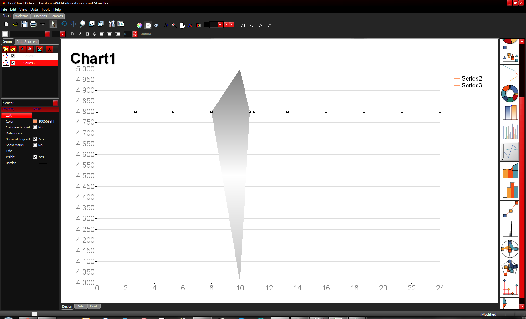

I was trying out compiled demo TeeChart Office. I am interested to have two series and paint between them but I found out that if I set both series to have line mode property set to Stairs area between them is changed which is fine but the painted area is not changed (it's same as series set to line mode to normal). I think this is a bug.
I attached image of problem and saved tee file.

I cannot upload a tee file while it says that tee is not valid file extensions.
Here is how to replicate this bug:
1. add two fast line series
2. add series band tool and assign both series to paint between them / select gradient or pattern type of fill
3. change each series Line mode property (check) to stairs
Kind regards.

Post by Yeray » Wed May 14, 2014 11:01 am
PoLabs wrote:I cannot upload a tee file while it says that tee is not valid file extensions.
Can't you upload the tee file in a zip?
PoLabs wrote:Here is how to replicate this bug:
I've reproduced this so I've added it to the public tracker.
http://bugs.teechart.net/show_bug.cgi?id=767
Feel free to add your mail to the CC list to be automatically notified when an update arrives.
