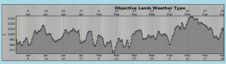

I am trying to capture a bitmap of a chart. I don't want to save it, I just need a bitmap to use in a image component, where I am adding a number of graphs in a grid.
I use the following code but the bitmap ends up spoiled with a lot of vertical lines. If I save the bitmap it saves correctly - am I missing something here of is it just not possible to grab a bitmap like this?? I thought it was the pixelformat property but none of them make a difference.

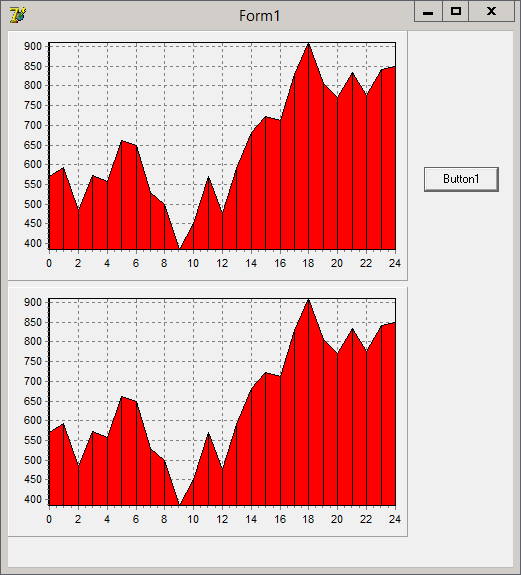

I was with the latest version.
Now I've tried with TeeChart v8 and removing the TBMPOptions I get this in a new simple project with just a TImage and a button:
Find the project attached:

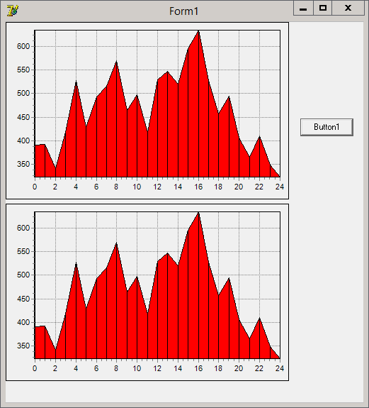

Adding this to the FormCreate to activate GDIPlus:
Chart1.Canvas:=TGDIPlusCanvas.Create;
It still gives me a good bitmap with TeeChart v8:
Maybe you are doing something else that is causing the bitmap not to be correctly exported, so yes, it would be helpful if you could arrange that simple example we can run as-is to reproduce the problem here.
