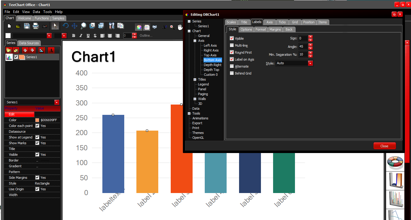

45 degree angled Labels overlap Bottom Axis
Post by dorrepaal » Thu Apr 24, 2014 11:17 am
We are using TeeChart VCL 2014 and cannot get the 45 degree bottom axis labels to work properly. They overlap the bottom axis:
Are we missing a new setting?

Post by Yeray » Thu Apr 24, 2014 2:26 pm
I've reproduced the problem so I've added it to the defect list to be fixed in future releases:
http://bugs.teechart.net/show_bug.cgi?id=742
Feel free to add your mail to the CC list to be automatically notified when an update arrives.
