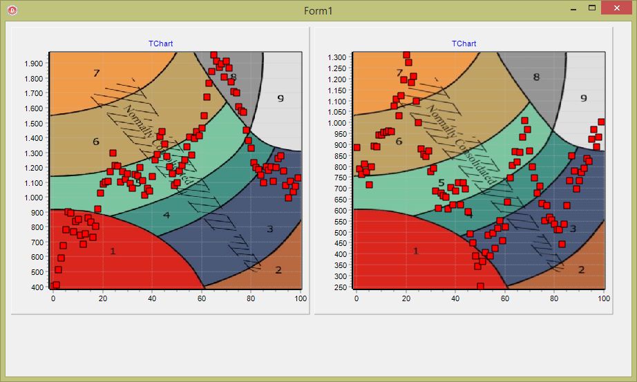

Ok, here is what I found by mistake :) After adding a filter to the back image performance looks normal. Attached is a sample project (also notice that the unfiltered image is not displayed correctly)

Thanks for the example project.
I could reproduce both problems here using the latest binary version but they are solves with our current sources:
I can send you a test version so that you can test if it solves the problem at your end.

Hello Narcis,
I can confirm that the test version solves the issue!!! Thank you very much for your prompt reply and support :)
