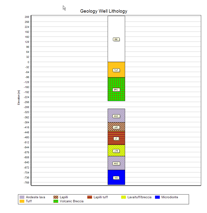

I am pleased to report that I have solved nearly all of my bar chart issues. I am using the self-stack option with a single series for each bar chart. I have implemented custom brushes and the can left-justify the legend text using
Chart.Legend.TextStyle := ltsPlain;
What I would now like to do is start a negative bar chart at a value greater than than zero - in other words a positive offset. I tried adding a new record to the data series with a positive value of 292, hoping the bar chart would first draw a positive bar and then start the negative bars from that point, effectively over-writing the positive bar (which would normally not show - I have coloured it white in the diagram for clarity). However, this does not happen, the negative bars start at zero (see attached diagram).
Is there an offset command that will enable the chart to start at a non-zero value?

I've split this from here because it looks to me as a quite different issue.
I've also observed you opened a ticked in the tracker here, asking to make the UseOrigin&YOrigin to work fine with mbSelfStacked style:
http://bugs.teechart.net/show_bug.cgi?id=726
I've confirmed the ticket.
