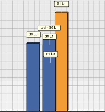

I looks like this:
So the bars with the same values are "overlayed". The same with "mbStacked".
Any idea how to fix this?

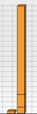

With your code I get this, that is slightly different to your image:
So I guess you are also modifying the bottom axis, setting a bigger range, making the bars to be drawn more close to the other bars.
On the other hand, looking at the data I see you are adding two values at the same XValue in Series1:
Is that what you desired? If so, how would you expect the Bars to be drawn?

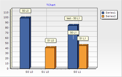

so the final looks like this:
So erverthing works fine. Thanx.
