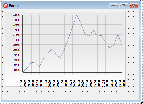

Post by Whookie » Tue Apr 01, 2014 4:54 pm
..when using multi line and TDateTime with special format. Please see screenshot and project (using last release, in XE5)

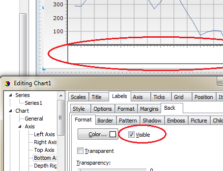

In addition there seems to be another major bug when trying to use the Labels "Back":
Set it to Visible and the text seems to be moved out of the chart

Whookie wrote:In addition there seems to be another major bug when trying to use the Labels "Back":
I'm not sure if it's related, but I've added it to the same ticket.

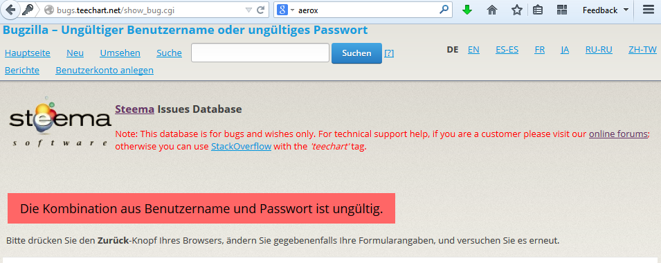

BTW: I can't add my self to those CC lists because when I log in user name and password seem to be wrong, when I enter my email I get an email with a link and when I click it token-time is over (approx. 20sec)...

Whookie wrote:BTW: I can't add my self to those CC lists because when I log in user name and password seem to be wrong, when I enter my email I get an email with a link and when I click it token-time is over (approx. 20sec)...
I've changed your password manually. Now the username and password are the same: your mail. Change it when you can.
Whookie
Posts: 28
Joined: Fri Sep 24, 2004 4:00 am
Re: Position of Labels is wrong on bottom axis..
Post by Whookie » Wed Apr 02, 2014 1:57 pm
maybe I'm on the wrong site? But I can't log in with my email as user name and password. I always get the following:
Post by Yeray » Thu Apr 03, 2014 7:53 am
Whookie wrote:maybe I'm on the wrong site? But I can't log in with my email as user name and password. I always get the following:
I can log in with your credentials:
username: g*****.k*****@e**.b**
pass: g*****.k*****@e**.b**
Maybe you are using a different mail account? It's the mail account you have registered in this forum.
