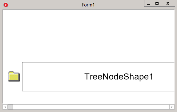

Re: TeeTreee Label size not scaled
Post by Yeray » Thu May 22, 2014 10:50 am
The project you posted above looks like this in XE6 and TeeChart v2014.11 for me here. Doesn't it for you?
