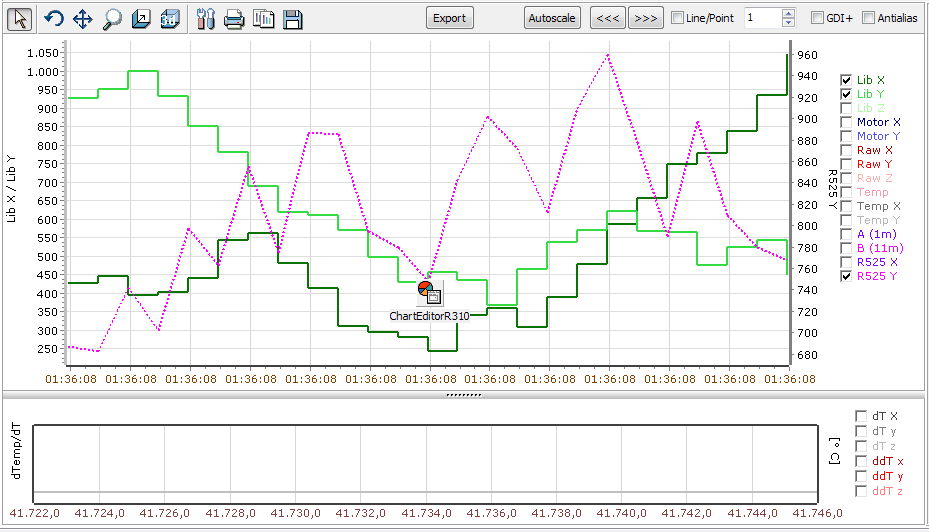

Hello every one,
a short question regarding syncing of two charts.
Both charts are filled with values at the same time -> Bottom Axis is the same in scale.
Unfortunately the start and end position (pixel) of the main chart part is not always the same (left / right axis visible, Legend width different, ...)
What I would like is to synchronize both charts width and left position in pixel coordinates. Regardless whether axis are visible or legend is visible.
Something like the maximum of both if one is changed.
Any idea how to manage this ?
Many thanks in advance.
