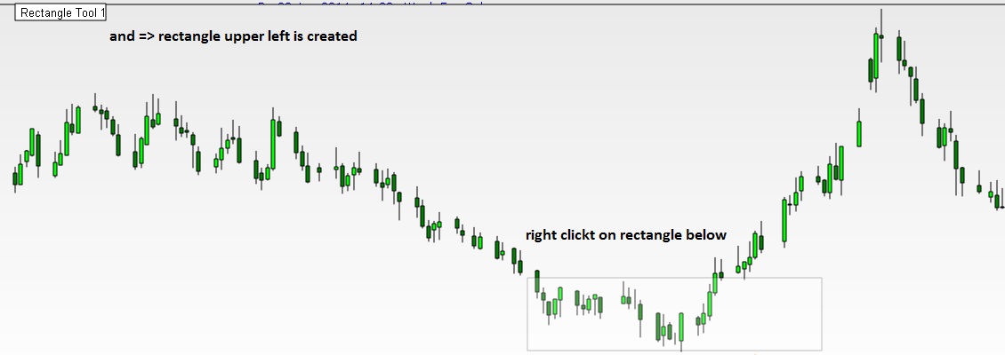

I attach you a screenshot of the origin and new rectangle, which I see.
I wanted the new one (which looks similar to a balloon hint in our screenshot example) looking alike the old one.
Cheryll

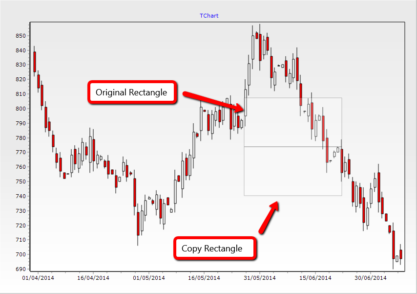

Cheryll

It seems to work fine for me here. Take a look at what I get: Find below the project I used to generate that image.
If you still find problems with it, please, modify the project so we can reproduce the problem here.
