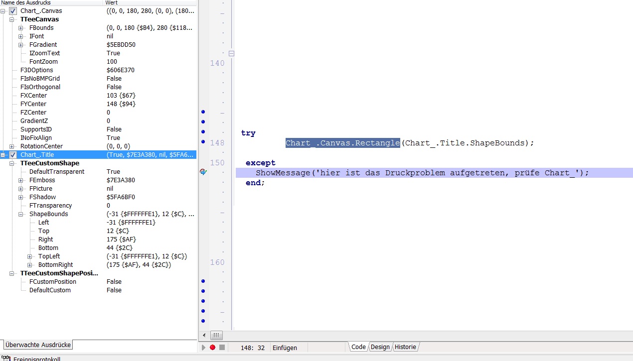

the access violation keeps coming (occasionally).
I took a screenshot of the line causing it and the values of the vars I can see in the debugging window.
I am really unexperience with those drawing of headers.
From that point of view I would expect somehing being calle "Rectangle" in the list, - but I cannot see it.

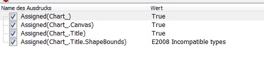

I keyed it in, waited for the violation to come and found this:
Assigned(Chart_.Title.ShapeBounds)
=> E2008 Incompatible types
Assigned(Chart_.ShapeBounds)
=> E2003 Undeclared identifier: 'ShapeBounds'
The other values are assigned fine.
What can I do? I have no idea, why these things are not assigned.
I never touched them at any other place in my code.

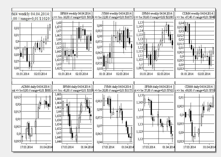

I will add you a screenshot. This is the print preview with 10 charts.
Every chart uses the code we are talking about up to 10 times.
And now look at the headers: The very first top left is malformed, the other 9 headers are ok.
The malformed header is the one which is produced, after I gave my Delphi the "continue" after the error.
IF the error occurs, it does it here:
I have a series of such preview charts. The first one works fine.
Then I "let make" the second preview and the third one....
=> the problem occurs on the top left chart header starting with the second page.

Chartist wrote:I keyed it in, waited for the violation to come and found this:
I'm sorry but the code I suggested to "full check" had an error. Here what I wrote:
yeray wrote:
if (Assigned(Chart_) and Assigned(Chart_.Canvas) and Assigned(Chart_.Title) and Assigned(Chart_.ShapeBounds)) then
  Chart_.Canvas.Rectangle(Chart_.Title.ShapeBounds);
Here what should be:
if (Assigned(Chart_) and Assigned(Chart_.Canvas) and Assigned(Chart_.Title) and Assigned(Chart_.Title.ShapeBounds)) then
However, I guess this change will fix the second error (Undeclared identifier: 'ShapeBounds') but not the first one.
If you still find the first error (Incompatible types for Assigned(Chart_.Title.ShapeBounds)), try removing that check.
Note I can't try that code because I don't have an application to reproduce the problem here. I understand this problem looks like randomly reproduced but it's difficult for us to help without reproducing the situation to handle.
Chartist wrote:I will add you a screenshot. This is the print preview with 10 charts.
I see the problem in images you post but I'd need to reproduce the problem here. Can you arrange a simple example project we can run to reproduce the problem here?

Post by Chartist » Sat Apr 12, 2014 9:04 am
here are the values of the corrected code taken in the exception loop after the access violation
corrected code.jpg (21.23 KiB) Viewed 19965 times
Cheryll
