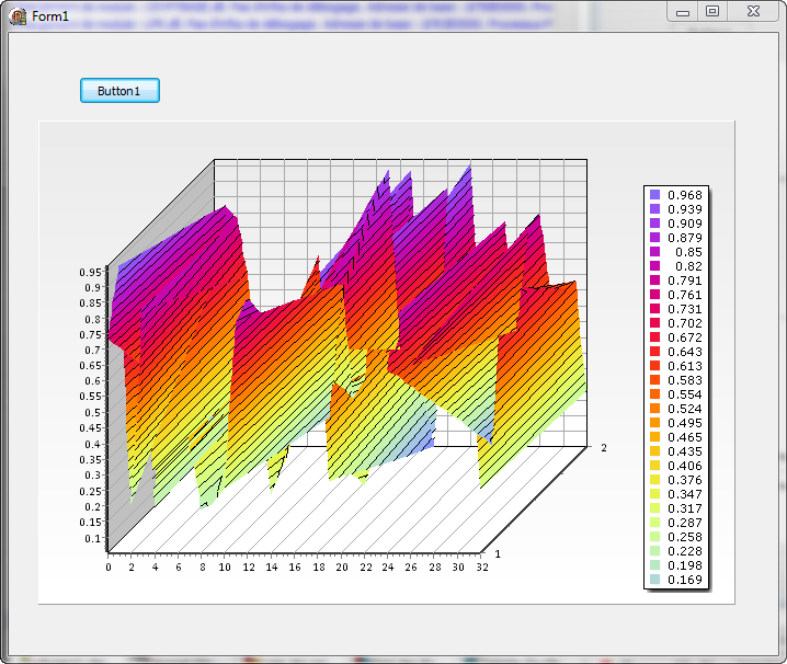

It works with this code:
     for x:=0 to 32 do
      (Serie as TSurfaceSeries).AddXYZ(x,random,1);
    for x:=0 to 32 do
      (Serie as TSurfaceSeries).AddXYZ(x,random,2);
I have this result:
