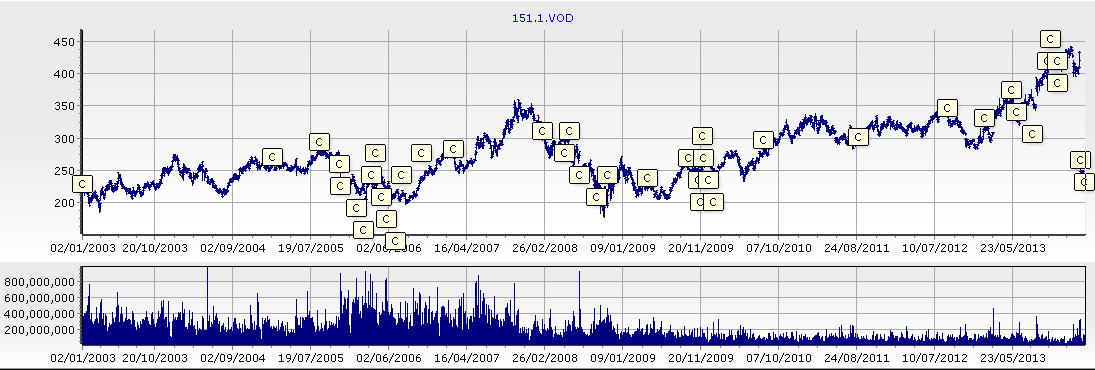

I have a candlestick chart which users use to view and correct financial data (pls see attached jpg). The Marks on the chart show where there are corporate actions 'C' or name changes 'N'. I currently use cross hairs and allow users to click and drag a rectangle to zoom into the chart to see the candle bars in more detail and then when a candle is clicked on using the OnClickSeries event I display the candle data for a user to edit.
What the users are asking for is when they click on a candle for a vertical line to be drawn on the chart so they can easily see where they have clicked. They also want this line to move when they click on another candle - all this needs to happen without losing any of the existing functionality.
I have read the various posts and tried a number of different things and none of these seem to display a vertical line and I wondered if you could help.
The final question from the users is its quite tricky to actually click on a candle so can they click anywhere on the chart and pickup the candle above or below where they click.
Many thanks
Barry

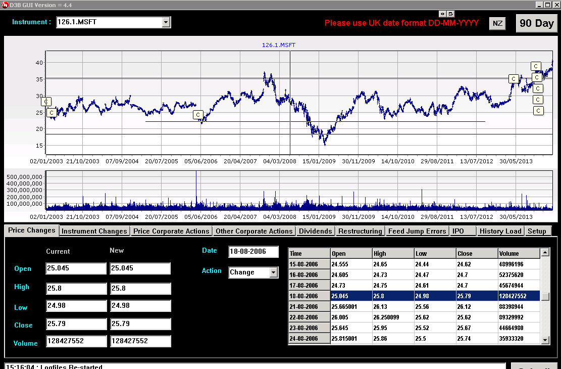

Sorry - I clearly have not made a very good job of explaining what I am after, but the demo you sent me is very helpful as it allows me to explain better.
If you run your demo and then select Editor then
Tools -> Color line - > Options and click "allow Drag" (I also made mine Red so I could see it better)
Now you can drag it left and right, what I want is the values in the string grid to change as I drag the color line over them - as it stands I still have to click on the Candle - This is already build into my code and I know how to do this, pls see the better screenshot
Also the
Is not available at design time, is there any reason for this please ?
Many thanks - especially for the demo code which allows me to explain the issue much better
Barry

Hi Barry,
Anyway, I modified testing app by code. Now at FormCreate I create the TColorLine like this:
I'll attach the new version of the testing project below.
I'll modify the testing project to have random values, so the changes can be seen clearly in the StringGrid.
I've also changed the Marks to show the index instead of using your event, just for testing what the StringGrid shows is the index of the nearest point to the line.
If I create the color line at designtime I see the same options in its editor than at runtime, don't you?
In my first attempt, I created it with AllowDrag=false because here:Barry wrote:If you run your demo and then select Editor then
I understood you didn't want the tool to be dragged. I understood it should be moved only when the user clicks on the chart or a candle.Barry wrote:The final question from the users is its quite tricky to actually click on a candle so can they click anywhere on the chart and pickup the candle above or below where they click.
ColorLine1:=Chart1.Tools.Add(TColorLineTool) as TColorLineTool;
with ColorLine1 do
Axis:=Chart1.Axes.Bottom;
AllowDrag:=true;
Active:=false;
Pen.Color:=clRed;
Have you tried to implement the second example I showed you here? I don't see it in your test project. I've implemented it adapting it so the color line now gets the position of the candle when you click over a candle, or to the nearest candle if you click on the chart or while you drag the colorline. It's like a snap-to-nearest feature.Barry wrote:Now you can drag it left and right, what I want is the values in the string grid to change as I drag the color line over them - as it stands I still have to click on the Candle - This is already build into my code and I know how to do this, pls see the better screenshot
I've created the color line at runtime, by code, because here in the forums it's easier to share code than options set at design time.Barry wrote:Also the
