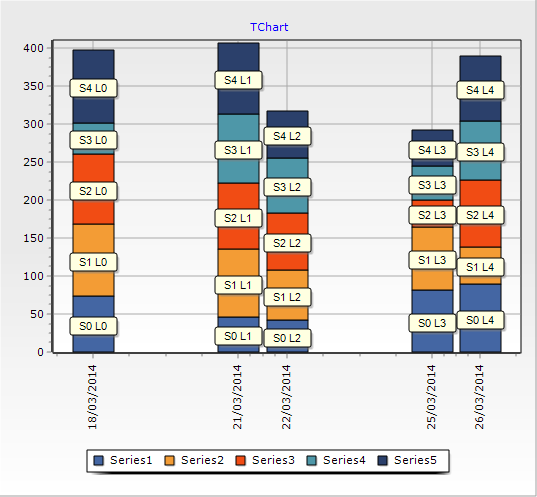

Is there currently any method of controlling the horizontal position of stacked bar charts? For instance, if a scientist were to measure a number of parameters at irregular time intervals, and wanted to display each set of parameters using a stacked bar chart, with the x-axis representing the time axis. This is a common requirement, and displaying this data at equal intervals does not accurately express the true data trends with time.

Hello Errol,
With mbStacked MultiBar style it's straightforward. You add the values to your series with XValue and the values of the different series in the same XValue will be stacked. Ie:
uses Series, DateUtils;
var i, j: Integer;
    tmpDates: array of TDateTime;
  Chart1.View3D:=false;
  setLength(tmpDates, 5);
  for i:=0 to High(tmpDates) do
    if i mod 2 = 0 then
      tmpDates[i]:=IncDay(Today, i*2)
      tmpDates[i]:=IncDay(Today, (i*2)+1);
  for i:=0 to 4 do
    MultiBar:=mbStacked;
    MarksOnBar:=true;
    MarksLocation:=mlCenter;
    CustomBarWidth:=40;
    XValues.DateTime:=true;
    for j:=0 to High(tmpDates) do
      AddXY(tmpDates[j], 25+random*75, 'S' + inttoStr(i) + ' L' + IntToStr(j));
  Chart1.Legend.Alignment:=laBottom;
  Chart1.Axes.Bottom.LabelStyle:=talPointValue;
  Chart1.Axes.Bottom.LabelsAngle:=90;
With mbSelfStack I'm afraid this can't be done because this MultiBar style doesn't use the XValues in the series to draw the bars; the x positions in the horizontal axis are just sequential. I'll add to the wish list the possibility to choose the XValue for the mbSelfStack MultiBar style to be drawn:
http://bugs.teechart.net/show_bug.cgi?id=646
