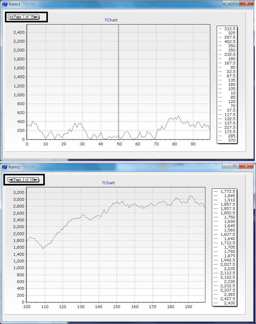

elmec wrote:When change the page of TChart, the cursorline disappeared,
the style of which is cssHorizontal...
while the one of cssVertical is OK.
Thanks for the project and the screenshots.
Looking at them, I understand both cssHorizontal and cssVertical work fine.
- When cssHorizontal, the cursor tool is drawn as an horizontal line at the center of the screen. If you don't specify an YValue for the cursor, TeeChart initializes it with the value in the center of the left axis range.
Then, changing to a bigger page, the left axis isn't altered and the cursor too is still visible.
- When cssVertical, the cursor tool is drawn as an vertical line at the center of the screen. If you don't specify an XValue for the cursor, TeeChart initializes it with the value in the center of the bottom axis range.
Then, changing to a bigger page, the bottom axis is altered but not the XValue of the cursor tool. Then, the cursor isn't drawn because its XValue is out of the bottom axis range.

I am sorry that I attached the images for the style of which is cssHorizontal,
which works well just by assigning new X offset when page changed..
I meant to attach the ones for the style of which is cssVertical,
the cursor with the style of cssVertical disappeared when paged changed...
Add I uploaded the new demo ...Please check it.
