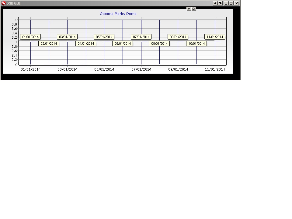

Here is a sample small bit of code that shows the problem.
There are 2 isuses
1. It shows a mark on every line, I assumed it would only show one when i=3
2. Each mark is a date
I'm expecting '3' when i=3 else nothing

Re: Adding a marker on a Candle chart
Post by Narcís » Fri Mar 14, 2014 4:19 pm
Hi Barry,
This looks like a bug to me. When there's an empty string mark nothing should be displayed instead of copying the same mark text for all points. I have added the defect to the bug list (ID639). If you sign up to bugzilla you'll be able to receive automatic status updates. Also, a workaround is adding OnGetMarkText event like this:
procedure TForm1.Series1GetMarkText(Sender: TChartSeries;
  ValueIndex: Integer; var MarkText: String);
  if Series1.Labels[ValueIndex]='' then
    MarkText:='';
That's because of you are setting them with this line:
      Series1.Labels[tmp] := DateToStr(EncodeDate (2014, 1, i+1));
Commenting it out solves the problem. So that your complete code would look like this:

Barry
Posts: 17
Joined: Tue Nov 13, 2012 12:00 am
Post by Barry » Fri Mar 14, 2014 4:35 pm
Re the 1st point, thanks, I will track the bug,
Re the 2nd point - sorry that's not correct, If I comment that line out the dates are not displayed along the x-axis although interestingly if I do comment it out then '3' appears on the X-axis under the relevant candle.
Just to be clear on what I want
1. I want dates along the X-axis
2. I want to be able to display a Mark against the actual candle where i=3
I think perhaps from your response this was not clear

Barry
Posts: 17
Post by Barry » Mon Mar 17, 2014 10:28 am
Sorry but this is now back where I started, just to make sure I cut and pasted your code and this is the result.
Pls see attached jpg
Barry
Picture showing issue
Post by Narcís » Mon Mar 17, 2014 10:32 am
Hi Barry,
Besides copying the code you need to subscribe the OnGetMarkText event in the series at design-time or at run-time like this:
  Series1.OnGetMarkText:=Series1GetMarkText;
