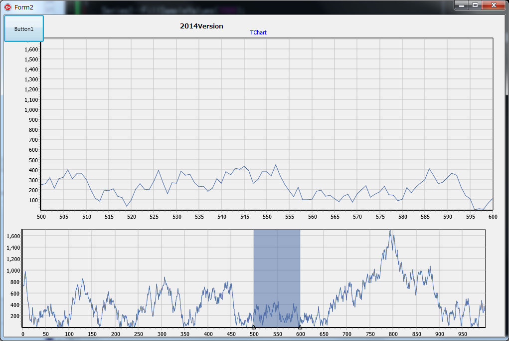

// Bug 1 About this bug, I have mentioned before.
ScrollPager->ColorBandTool->StartValue = 500;
ScrollPager->ColorBandTool->EndValue = 600;
// Without the line below, the position set of ColorBandTool above not work!
Chart1->BottomAxis->SetMinMax(500, 600);
// Bug 2 ?
// ColorBandTool cannt be resized even I tried to drag it.
Refer to the example project.

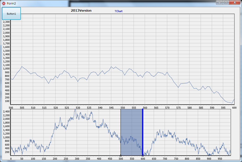

// Bug3
There is no effect even I have changed the property.
But the 2013 version is OK.
See the images I have attached.
TScrollPagerTool2.zip
(78.75 KiB) Downloaded 554 times

elmec wrote:// Bug 2 ?
Add this at the Form creation:
  ScrollPager->ColorBandTool->StartLine->Visible=true;
  ScrollPager->ColorBandTool->EndLine->Visible=true;
I've added it to the defect list to be fixed in future releases:
http://bugs.teechart.net/show_bug.cgi?id=623
elmec wrote:// Bug3
I don't understand this part. Could you please explain it with detail?
I don't even see any "Bug3" mentioned in the project you attached

// Bug 2 ?
Thanks! So you means that version 2014 is different with version 2013, the start and end line is invisible by default.
// Bug3
Because the start and end line is invisible by default,
so I had thought that there is no effect even I changed the property of the lines.
It's my fault..sorry!
