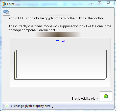

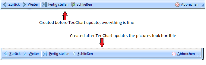

After updating from TeeChart Pro 7.06 to TeeChart Pro 2014, newly assigned glyphs to their bar buttons look horrible.
I went back in a testing VMware to a snapshot that was created right before updating TeeChart and everything was still fine there.
(check attachment image)
I checked the dfm-file part of the same image, and it differs between TeeChart 7 and TeeChart 2014.

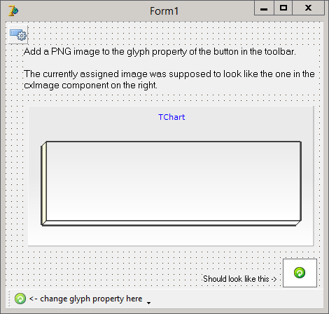

This is how it looks, always at design time: I see the bitmap at the bottom-left looks different than the bitmap at the right.
I've changed the bitmap to the following through the glyph property as indicated: I've also changed the TcxImage in the right to use png above too, and added a TChart.
Everything looks fine for me here: Check out the modified project here:

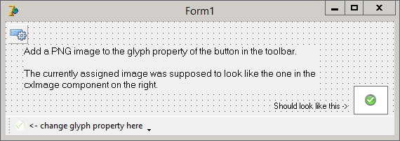

I downloaded your demo and opened it in Delphi 7. The button you changed looks fine for me.
However, I downloaded the PNG file that was attached in your posting and changed the picture through the glyph again to that image.
This is the result: The difference here is, that I installed DevExpress prior to updating TeeChart to v2014.10. But I already tried reinstalling DevExpress from scratch, and the picture was still screwed up.
