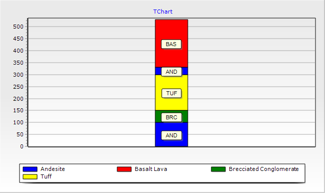

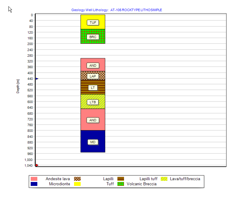

Thanks for your help to date. Now I have a really tricky question. I have created two series, one representing the rock types down a well, and the other an list of unique rock types, sorted alphabetically. Using these, I can display two stacked bar charts (see attachment). I would like to show the first stacked bar chart but display the legend appropriate to the other. I can hide one of the charts easily enough by setting the Y-axis value to 0 for all data points. I have the colors correct for the 2nd series (by using a Legend.Symbol.OnDraw event) but cannot change the text (GetLegendText seems to always gets the text for the first series) and I cannot suppress the extra legend symbols. Ideas welcome.

In general, if you have two series in a chart and you only want one of them to be shown in the legend, you can hide a series with ShowInLegend:=false
However, I'm not sure to understand what's the exact configuration of your chart.

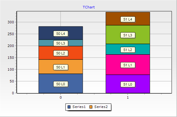

Here is the minimum code to create a chart with two TBarSeries SelfStacked, similar to what I understand you are doing:
uses Series;
var i, j: Integer;
    tmpColor: TColor;
  Chart1.View3D:=false;
  for i:=0 to 1 do
    MultiBar:=mbSelfStack;
    MarksOnBar:=true;
    MarksLocation:=mlCenter;
    ColorEachPoint:=true;
    for j:=0 to 4 do
      if (i=0) then
        tmpColor:=OperaPalette[j]
        tmpColor:=MetroPalette[j];
      Add(25+random*75, 'S' + inttoStr(i) + ' L' + IntToStr(j), tmpColor);
  Chart1.Legend.Alignment:=laBottom;
  Chart1.Axes.Bottom.LabelStyle:=talValue;
However, I don't get a legend like yours. With the default LegendStyle (lsAuto), I get two items in the legend, one per series:

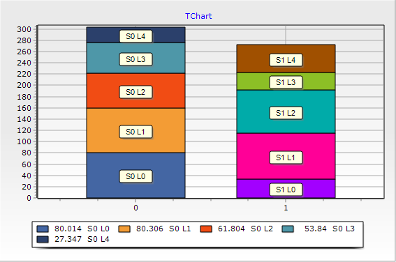

And if I add this to the code above to force the values to be shown in the legend:
  Chart1.Legend.LegendStyle:=lsValues;
Then I get only the values of the first series in the legend:
It would be helpful if you could take the code above and modify the minimum so it can reproduce the situation you are trying to handle here.

Errol wrote: However, I still have one problem. I would like to left-justify the legend text. I have tried Legend.TextAlignment := taLeftJustified but no joy. How do I left justify the legend text?
What do you mean with "left justify"? How does your legend look at the moment and how would you like it to look?

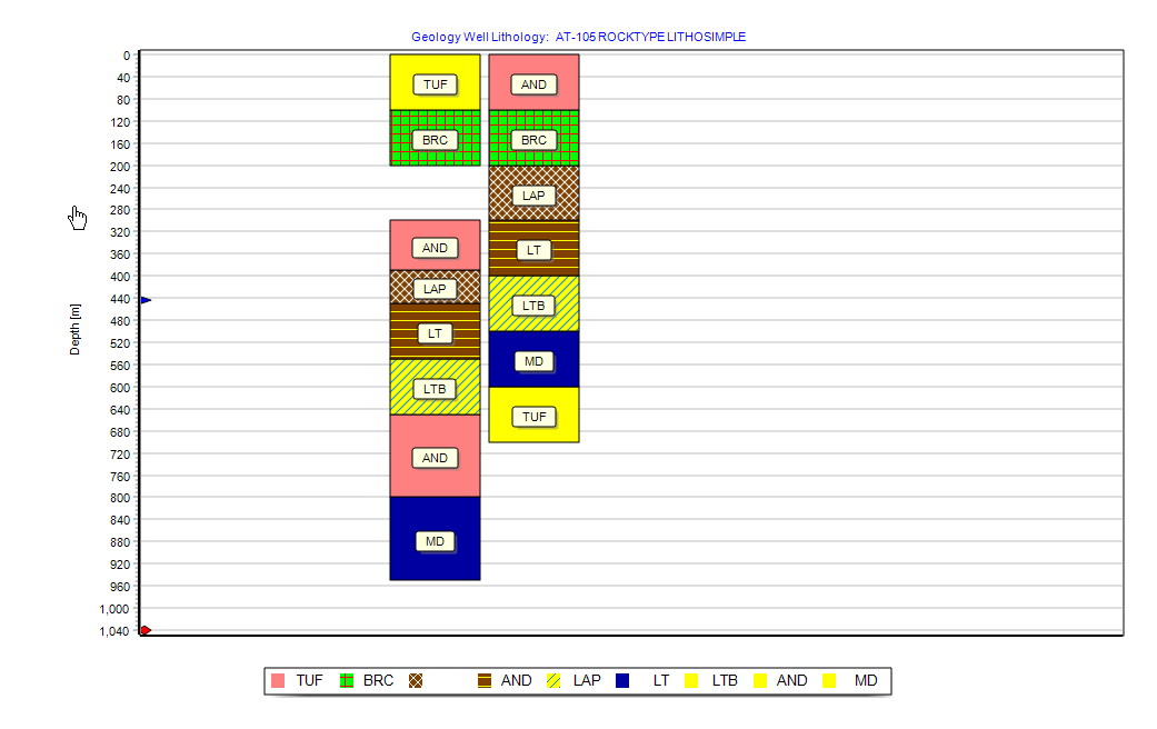

Sorry I meant to attach a diagram but forgot, so here it is. I would like to write the text immediately following the legend symbol, rather than having it justified to the right side of the legend text space as at present.
Best regards

Errol wrote:I would like to write the text immediately following the legend symbol, rather than having it justified to the right side of the legend text space as at present.

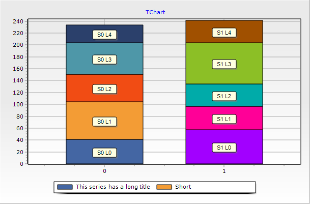

I understand what you see and what you want to obtain, but I can't reproduce the situation you have.
I'm trying to reproduce it with the code I posted above, here, adding these two lines of code at the end of the FormCreate method:
  Chart1[0].Title:='This series has a long title';
  Chart1[1].Title:='Short';
And the legend I get shows the legend text left justified:
Please, as I said above,
Yeray wrote:It would be helpful if you could take the code above and modify the minimum so it can reproduce the situation you are trying to handle here.

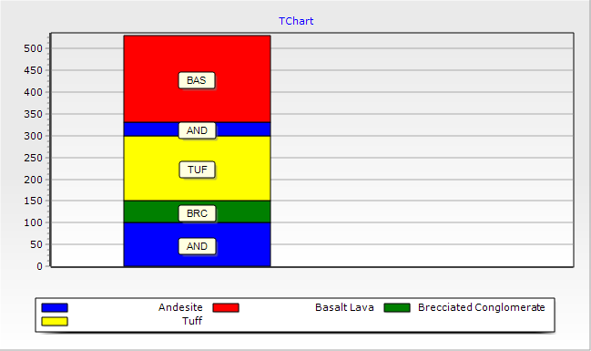

Here is the modified code that exhibits the offset legend. I have put the data record by record into two memory tables to be able to use the DataSource, LabelsSource and similar commands.
Best regards
Errol

I've simplified the code you posted to not to use tables and I could reproduce the problem you described above:

However, I see you are adding only one series for the legend, and adding values with labels to this series. Note this is not exactly what I suggested you above:
Yeray wrote:As an advance, I can tell you that some customers with problems setting their legends prefer to remove all the series they have from the legend (with ShowInLegend:=false) and then they add as many dummy series (series with no values) as entries they want in the legend. These dummy series are the ones that will be shown in the legend so you may want to change their color, pattern or title.
To clarify, my suggestion is to create one series per entry you want to have in the legend. Then, there'll be no need to use OnGetLegendText event.
Here you have an example:

Hi Yeray
Thanks for your suggestions. However, creating a separate series for each legend item causes another problem. I use an OnDraw event to draw the pattern, foreground and background colors, as follows:
self.Owner.Chart.Legend.Symbol.OnDraw:=LegendDraw;
Unfortunately, the value of ValueIndex in the LegendDraw procedure is now always -1, so I am unable to select the correct data from the dataset to draw the legend symbol. The LegendDraw procedure appears to know the position of the symbol rectangle, but not its index in the legend.
I have tried rewriting the LegendDraw event as a regular procedure and calling it as each series is created, but I do not know how to find the legend symbol rectangle coordinates.
Suggestions appreciated.

Good morning Yeray
Further to my previous post, I am still having problems with using the Chart1.Legend.Symbol.OnDraw event when the legend is derived from a number of series rather than a single series. In the multiple series case, the value of ValueIndex in the OnDraw event is always set to -1, and so cannot be used to determine which series data is applied to each legend symbol. I thought I could get round this by using a global index variable to count through the legend positions, but then found that the OnDraw event does not always start at the first legend position, so the legend symbols are drawn in the incorrect positions.
Is there an alternative method to determine which symbol position the OnDraw event is referring to, or do you plan to modify the code so that ValueIndex specifies this position?
I look forward to your comments.

Hi Errol,
You could try have your own index that is sequentially incremented at the Legend's Symbol OnDraw event and initialized each time the chart is being repainted, using come event that is being called before the OnDraw event, like OnGetLegendRect event. Ie:
var DrawingIndex: Integer;
  Chart1.OnGetLegendRect:=GetLegendRect;
  Chart1.Legend.Symbol.OnDraw:=LegendSymbolDraw;
procedure TForm1.GetLegendRect(Sender:TCustomChart; var Rect:TRect);
  DrawingIndex:=0;
procedure TForm1.LegendSymbolDraw(Sender:TObject; Series:TChartSeries; ValueIndex:Integer; R:TRect);
  with Chart1.Canvas do
    Brush.Style:=TBrushStyle(DrawingIndex+2);
    Rectangle(R);
  Inc(DrawingIndex);
Errol

Good morning Yeray
Your suggested solution to the problem of the unknown position of the legend symbol worked - thank you. However, I have the following comments.
1. Rather than having to invoke an OnGetLegendText event, this problem would be better solved if the value of ValueIndex passed to a Legend.Symbol.OnDraw event reflected the position of the legend symbol, for both the single series and the multiple series cases. Would this be possible to implement in a future release?
2. The solution to the earlier problem of the legend text not left-justified when it is parsed and edited in an OnGetLegendText event was to use multiple series for the legend. However, this is not particularly satisfactory as I have a number of stacked bars on my chart and they now move around when I move between datasets with different numbers of legend items, as the total number of series changes. Do you plan to fix the post-parsing left-justification error in a new release?
3. These problems and solutions have raised another question which I will ask in a new thread.
Thanks and regards
Errol
