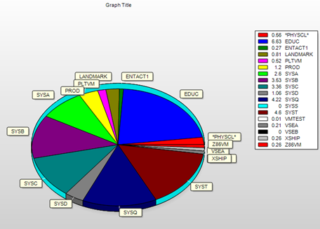

In our application we display some 3d pie chart. With the new version, it seems there is a rendering problem (the 'slice' of the pie chart is visible both above and below).
I will attach a screen capture to illustrate this.
Is it a known problem? Is there a solution to this ? Do you plan to fix it soon ?
As you can see the 3d effect is not ok

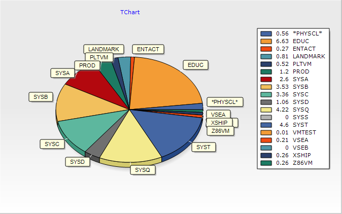

I'm trying to reproduce the problem with the following simple example but the pie I get looks correct:
uses Series;
  with Chart1.AddSeries(TPieSeries) do
    Add(0.56, '*PHYSCL*');
    Add(6.63, 'EDUC');
    Add(0.27, 'ENTACT');
    Add(0.81, 'LANDMARK');
    Add(0.52, 'PLTVM');
    Add(1.2, 'PROD');
    Add(2.6, 'SYSA');
    Add(3.53, 'SYSB');
    Add(3.36, 'SYSC');
    Add(1.06, 'SYSD');
    Add(4.22, 'SYSQ');
    Add(0, 'SYSS');
    Add(4.6, 'SYST');
    Add(0.01, 'VMTEST');
    Add(0.21, 'VSEA');
    Add(0, 'VSEB');
    Add(0.26, 'XSHIP');
    Add(0.26, 'Z86VM');
Could you please modify the code above (or arrange a new simple project) so we can reproduce the problem here?
