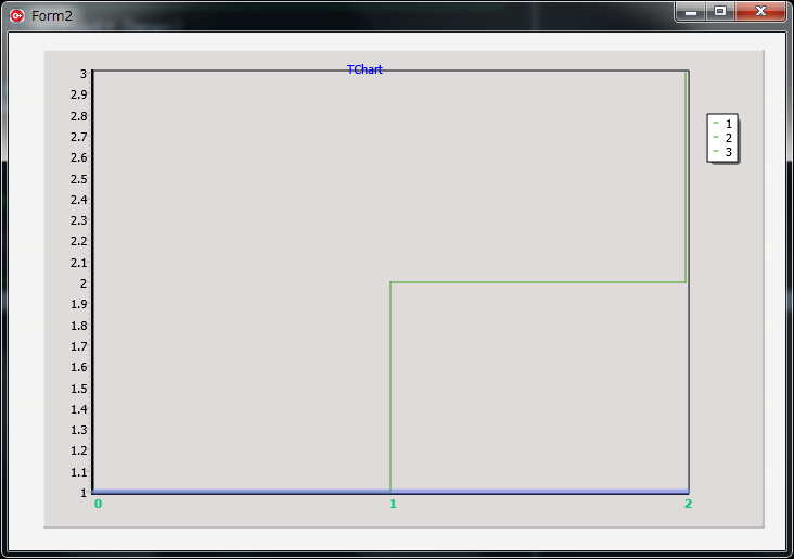

Failed to change the offset of CursorLine Tool by following code..
	cursorLine->Snap = true;
	cursorLine->Series = Series1;
	Series1->Add(1.0);
	Series1->Add(2.0);
	Series1->Add(3.0);
	// Try to change the Y axis offset of Curorline to 2.0,
	// but failed.
	cursorLine->YValue = 2.0;
CursorLine.zip
Example project
(74.68 KiB) Downloaded 563 times

If I add some code like below...
when I clicked the Button1, it seems working well...
void __fastcall TForm2::Button1Click(TObject *Sender)

Re: Failed to change the offset of CursorLine Tool
Post by Yeray » Mon Mar 03, 2014 4:07 pm
This is because the chart needs to be repainted before it can correctly apply the new position.
The easiest way to workaround this is to assign the new position twice at the startup:
Post by Yeray » Tue Mar 04, 2014 2:55 pm
This was a bug we already fixed here:
http://bugs.teechart.net/show_bug.cgi?id=468
However, this seems to be broken again.
We've done another modification that I hope will fix this definitively.
This will be included in the next maintenance release.
