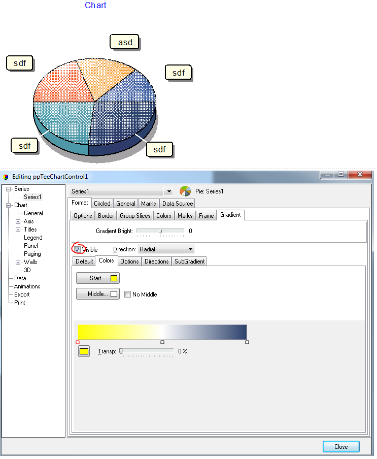

Hello.
We are using TeeChart Pro 2014 together with Report Builder 15.02 in Delphi 7.
Digital Metaphors told me, that they only call an internal TeeChart routine to export the chart to a metafile image and then display that image on the report.
When using gradients within the chart, the metafile image looks quite horrible.
We just updated from TeeChart Pro 7.06 to 2014. The metafile image generated by the old TeeChart version looked pretty ok.

This is a GDI+ bug with gradients (ID562). If you sign up to Steema Software's bugzilla system, you'll be able to receive automatic updates. The GDI+ canvas was set as the default canvas in May 2013 release (see version info page) for aesthetic purposes as it offers superior rendering but GDI is faster than GDI+ so is still preferable in some scenarios.
A workaround to the problem is using the GDI canvas for the export:
uses TeCanvas;
 Chart1.Canvas:=TTeeCanvas3D.Create;
 Image1.Picture.Graphic := Chart1.TeeCreateMetafile(True, Rect(0, 0,
Chart1.Width, Chart1.Height));
 Chart1.Canvas:=TGDIPlusCanvas.Create;
Does using GDI canvas for the export works fine for you? Is it available in Report Builder?

Using GDI instead of GDI+ looks indeed a lot better in this case.
I have no idea about Report Builder, but I just sent them a mail.
Can you tell me how to check at runtime whether the gradient is active or not?

DeskCenter wrote: Can you tell me how to check at runtime whether the gradient is active or not?
Yes, you should use TPieSeries.Gradient.Visible property, for example:
  if Series1.Gradient.Visible then
    //Use GDI canvas to export
  end
    //Use GDI+ canvas to export
