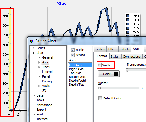

Is there a way to control label offset from axis and ticks?
Because I've encountered a strange problem with labels and invisible axis: there is no offset at all.
Interestingly, if you simply use zero width for axis than offset will be applied.

I've added it to the tracker:
http://bugs.teechart.net/show_bug.cgi?id=608
Fell free to add your mail account to the CC list to receive automatic updates of the status of the issue when they arrive.
