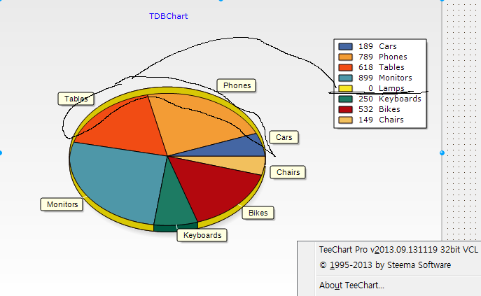

Hello.
Am running 2013 Pro VCL. (delphi xe5)
Can replicate this by simply dropping a TDBChart component on the form, and use the Chart Editor.
Select 'Data', and then change some of the values to zero - you will see the pie (3D) display is corrupt (edges).
If I could just add a legend for the zero value without drawing the empty slice that would be fine.
This behavior only happends on 2013 - delphi xe5 teechart standard is fine.

Hi arabica,
I'm not able to reproduce the issue here either at design-time or run-time using this code:
uses VCLTee.Series;
  Chart1.AddSeries(TPieSeries.Create(Self)).FillSampleValues;
  Chart1[0].YValues[4]:=0;
If the code snippet above reproduces the problem at your end then you can expect this being fixed in the next maintenance release which will be probably published next week.
