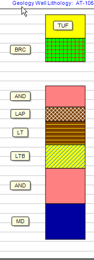

I am using a Stacked Bar Chart to represent a lithology column from a well. As an alternative to drawing a legend, I want to be able to put labels directly on the bar chart. However, they always draw in the next lithology, and there does not appear to be a command akin to Marks | Arrows | Distance in the Chart Editor that I could set to a negative value and shift the labels to the centre of the strata. As a result, the labels end up as in the attachment. Any suggestions welcomed.

Thanks for your reply. I agree that Marks.ArrowLength can be set to a negative value (I had a code error before) but I am still unable to individually position each mark. The marks offset is always the same and in pixels so that when I zoom the label is no longer in the centre of the bar. The MarksOnBar command worked but put the marks just below each bar rather than in the centre of the bar. The code I use is shown below (Depth is the vertical length of each bar in the stack), and the results are in the attachment.
Clearly I am doing something wrong - what might it be?

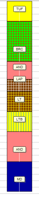

Hi Yeray and Narcis
I am pleased to report that the following code places the marks in the center of each bar, and they remain in place when the chart is zoomed.
Many thanks
Errol

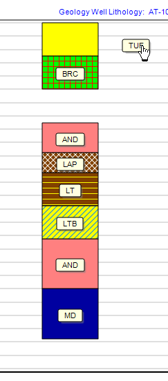

I am able to place marks in the center of each bar on my stacked bar chart as required, and they stay in the correct place when I pan or zoom the chart. However, if I first drag one of the marks, this appears to lock the marks in the chart (see attachments). The only way to reset is to select another data set. How can I reset the marks to auto as I pan or zoom? I use an OnAfterDraw event to allow marks dragging (see code snippet).

Thanks for the suggestion regarding the OnAfterDraw event. I inherited this code and hadn't really thought about it, but zooming and panning now works much better since I adopted your suggestions.
I have overcome the "sticky" marks by simply calling Chart.RefreshData on Zoom, UndoZoom and Scroll. However, it would be nice to do this only if a mark has been dragged. Is there a Marks.HasBeenDragged boolean that I can interrogate to see if I need to refresh the chart?

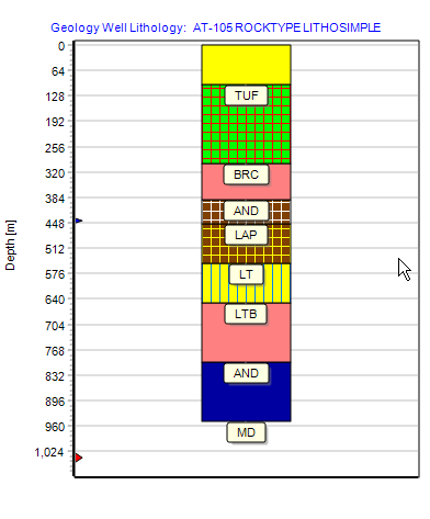

Is there any way to left justify and offset marks on a (vertical) stacked bar chart. Properties such as MarksLocation and Marks.TextAlignment seem to control placement in the vertical direction, but I would like to control in the horizontal direction.
Errol

Here you have an example of custom positioning for the Bar Marks:
