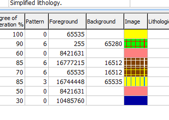

I wish to use a stacked bar chart to plot a well lithology column from a query from a database. The fields in the query are:
Depth Increment
Rock Type
Pattern // a number relating to one of the standard Windows patterns
Foreground // a TColor value as integer
Background // a TColor value as integer
I use a single TBarSeries with all the data from one well to plot the bar chart with patterns and colours (see attachment). How can I plot a legend showing the pattern and colours of each Rock Type and the name of the rock type? Details of the code I use are in the Stacked Bar Chart topic.

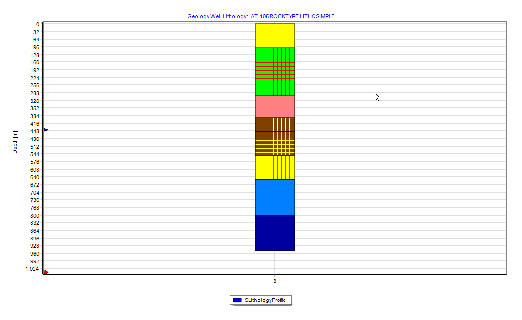

I am trying to replicate the pattern and colours used to fill the bars of a stacked bar chart in the legend. To do this, I use the OnDraw event to fill each legend symbol with a bitmap generated from the pattern and colour, with code as shown. Brush.Color and Brush.Style get the correct values but when I save the bitmap to file and check its contents it is always a white rectangle. Any ideas?

By trial and error, I solved the problem of drawing legend symbols as filled patterns. The trick is to first write the pattern to a rectangle at Left = 0, Top = 0 and then draw this pattern in the legend symbol space. This procedure is a legend event, called as follows:
Self.Owner.Chart.Legend.Symbol.OnDraw:=LegendDraw;
Also set LegendStyles as follows:
self.Owner.Chart.Legend.LegendStyle := lsValues;
I have attached the code if other users are wrestling with this problem.

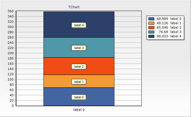

I understand your situation can be resumed with this code:
uses Series;
var i: Integer;
  Chart1.View3D:=false;
    MultiBar:=mbSelfStack;
    MarksOnBar:=true;
    MarksLocation:=mlCenter;
    ColorEachPoint:=true;
    for i:=0 to 4 do
      Add(25+random*75, 'label ' + IntToStr(i));
That gives this result:
Could you please confirm this shows the problem you are trying to evade?
If so, as you've noticed, you have two options to only show the label and not the value:
- Edit the Legend.Items array. You can remove the first string (Text string) from all the items in the array. Just note you need to force a chart repaint before doing so:
var i: Integer;
    MarksOnBar:=true;
    for i:=0 to 4 do
  Chart1.Draw;
  for i:=0 to Chart1.Legend.Items.Count-1 do
    Chart1.Legend.Item[i].Text:='';
- Use the OnGetLegendText event as follows:
uses Series;
var i: Integer;
    MarksOnBar:=true;
    for i:=0 to 4 do
  Chart1.OnGetLegendText:=GetLegendText;
procedure TForm1.GetLegendText(Sender:TCustomAxisPanel; LegendStyle:TLegendStyle; Index:Integer; var LegendText:String);
  if Index>-1 then
    LegendText:=Chart1[0].Labels[Index];
